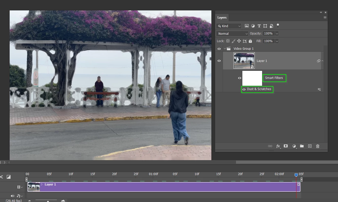

I just tried the usual trick with Video layers.  Make the layer a Smart Object and apply the effect.  The Dust & Scratches filter appears to have worked on all frames, and it didn't take forever to render.  Of course, Dust & Scratches is a very crude tool for cleaning frames, but the SO trick only works with the filters.  It's not an Ai super tool that tracks scratches frame by frame.  Worth a try though.
I just gave it a more severe test with Camera RAW, and it still worked rendering out at about two frames per second.
