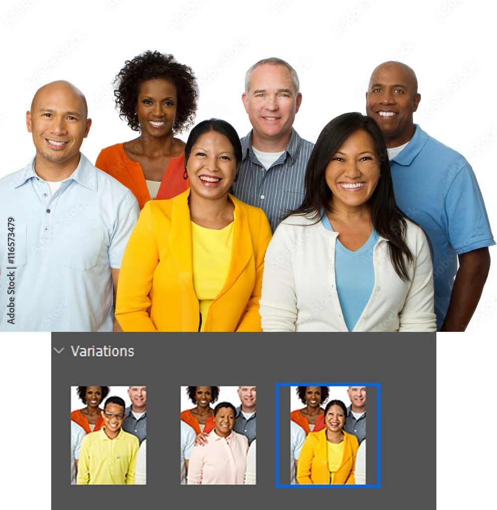

I did it in 2 times as you can see on the pictures below.

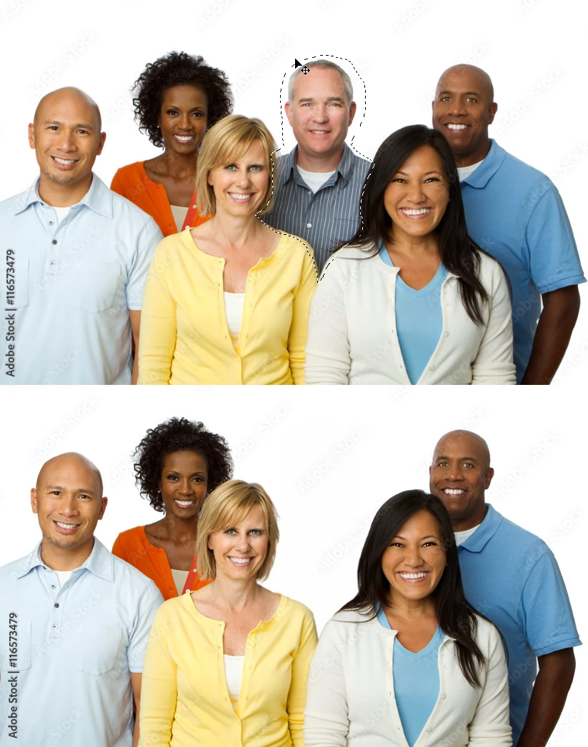

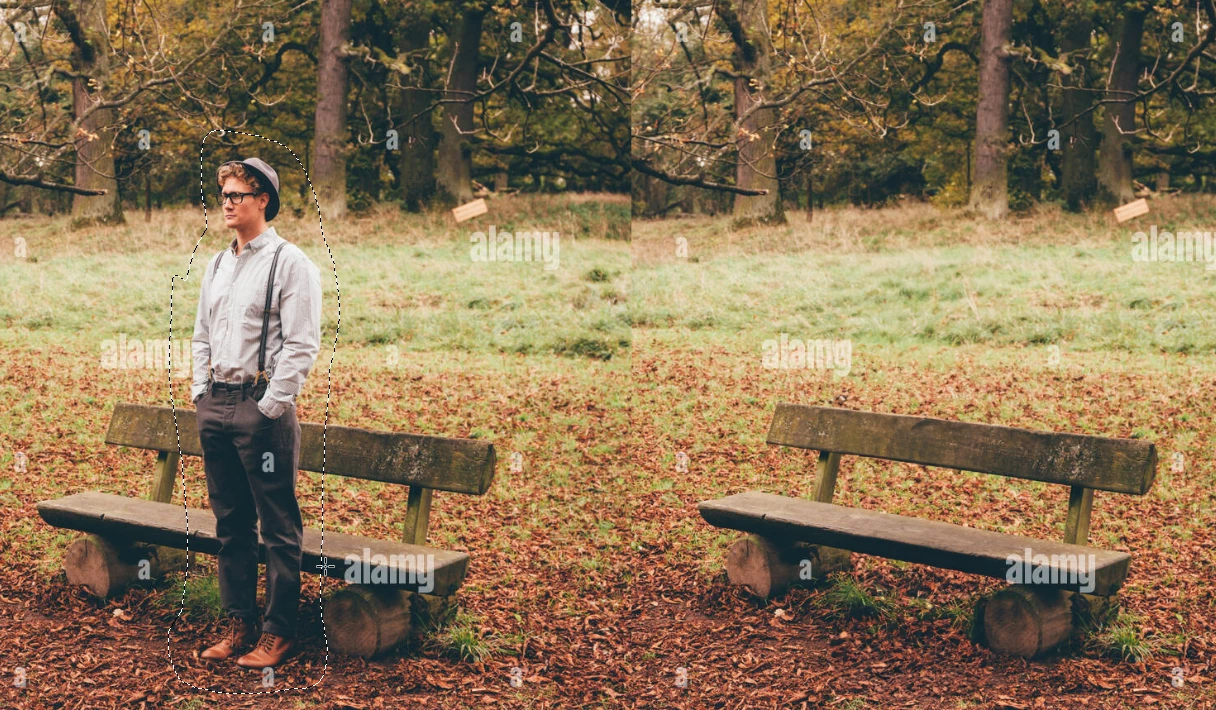

With the selection below, Generative Fill did a good job.
But the Remove Tool did an equally good job.
In a groups situation like below, a fairly tight selection did an OK job with the man in the background, but Generative Fill would not be able to give a good result if you asked it to remove one of the two ladies in the fron row.
This is what happened when I tried, and it looks rather like what you described
