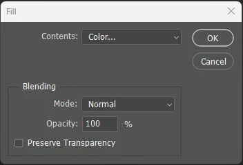

Trevor, I believe I've previously mentioned that I have pre-selected my "color of choice" (which is green) from the Fill contents menu (which includes three (3) options: Foregound Color, Background Color, and Color).  You guys do use Photoshop/Photoshop Beta right?
Anyway, I have already solved this issue.  Somehow within the Fill contents menu, the box for "Preserve Transparency" got checked.  Unchecking it solved the problem.

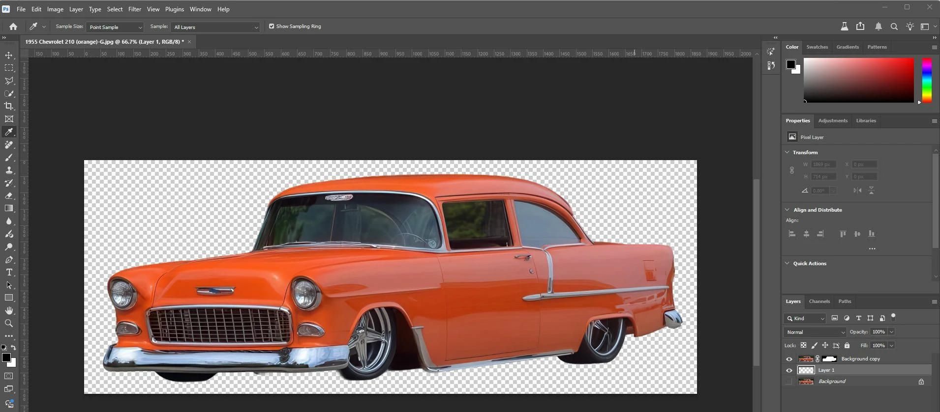

Well CShubert, I believe I explained it fairly well in my last reply.  I've already clearly indicated that I am using the latest version of Photoshop Beta (v26.11 20250820 m3189) as to the rest the the jargon you specified it would not have anything whatsoever to do with the procedure in question.  A procedure that has worked for years in the regular version of Photoshop (and still does), and one that has worked in PS Beta untill two (2) days ago.
I believe I have spelled out my procedure clearly enough previously, so see no need to repeat myself.  However, I am uploading a screenshot.  I did a cutout of an object (a car) and created a blank layer beneath it (see Layer 1). With "layer 1" tagged, I simply Shift+F5 and select "Color".  That function no longer works as my selected color is indicated but does not fill the intended layer.
