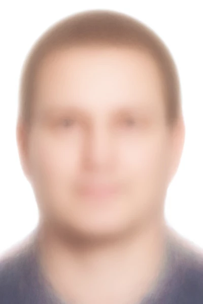

    kaarakainen
    April 11, 2017
    Thank you, great information! I first batch resized every picture to the same dimensions (made them quite small, as calculating takes quite a lot of time)  and then tried the method you suggested. It kind of works, although the result is quite blurry. I'm wondering whether it's the result of slight variation between alignment of faces in the pictures, or the stacking modes or something else. Nevertheless, interesting results. Here are 1022 portraits blended together, and within the group of people there are people of ages between about 18-65 from both genders.
    I'm wondering if there would be ways of improving and getting a bit more definition to the picture, or if it's impossible. What do you think? Anyway, great advices so far!
    K´mo
    April 11, 2017
    I think that alignment is important to get eyes, nose and mouth aligned properly. Did you try auto align layers? This is something that I've been also thinking sometimes but never did it. So your results are interesting. You also could try different stacking modes. This really is something I am not very familiar with. If I had suitable collection of faces, I could try different solutions.
