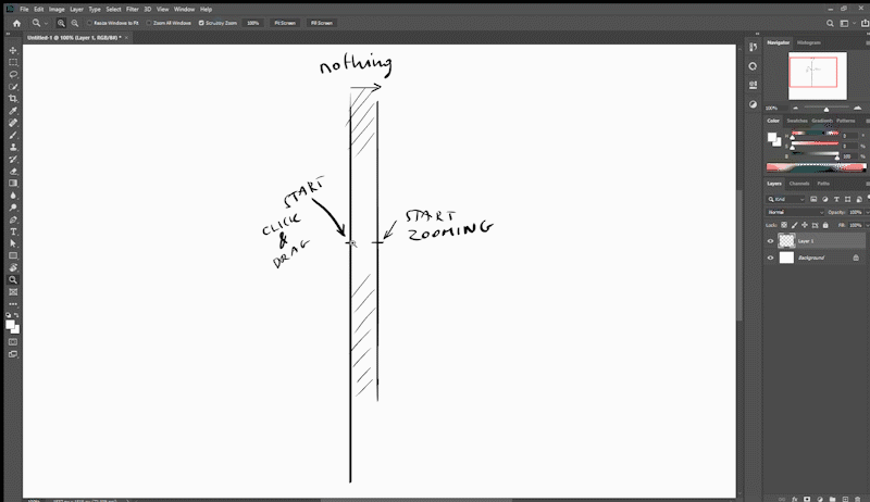

I have the same issue using Wintab. Switching to windows ink allows scrubby zoom to respond faster but in return I have a laggy patch tool. Another issue but might be related. Basically it takes a longer drag before zooming begins while windows ink, I can drag a little and it will immediately zoom as expected. I did not experience this in 21.0.3.
