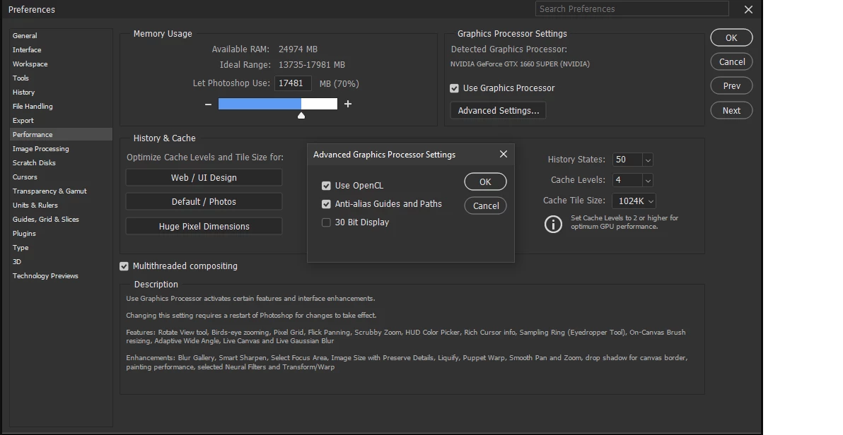

Not sure what's going on here, but occasionally (still not sure what the triggers are), PS will just not let me navigate / zoom anymore and tool functionallity is invisable.  I know it's actually zooming / navigating because the side bars are moving, but nothing changes on the artboard / screen.  I can save work and restart PS and it starts working again for a time.  I feel like this only started with this most recent update.
Attached is my system info.  Please help!

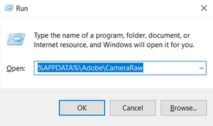

  • On Windows, the GPU info & Logs location is %APPDATA%\Adobe\CameraRaw. A shortcut to get to this folder on Windows is:
    • Press the Windows + R
    • Enter %APPDATA%\Adobe\CameraRaw
    • Rename the GPU & Logs folder in this directory by adding .old at the end. (GPU.old & Logs.old)

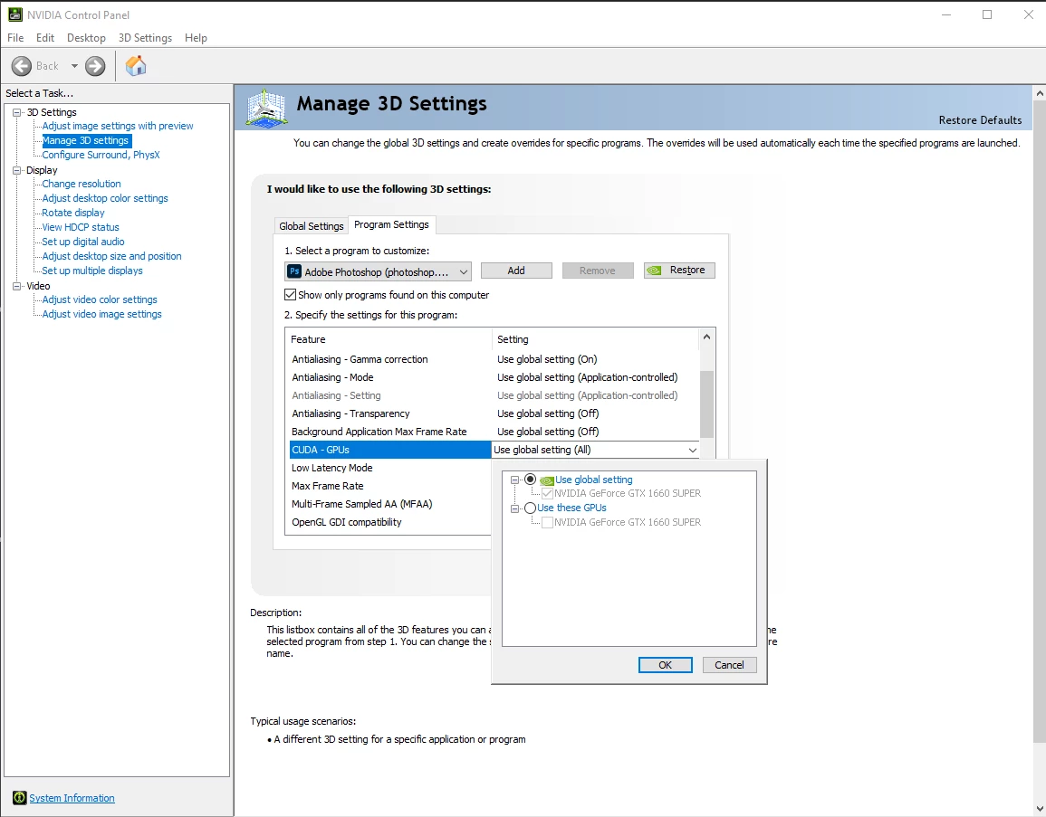

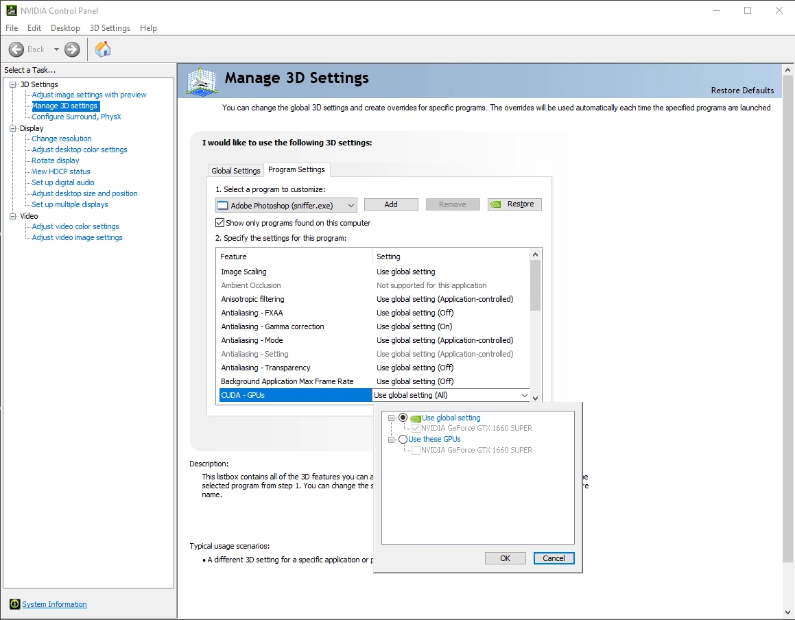

I followed the link and the instructions, but it appears photoshop and sniffer were already added to the 3D settings and I don't see anywhere in the drop list that doesn't already have my GTX card chosen or Use Global Settings, which is set for the GTX card.  But I honestly don't see a straight up option in the drop list for selecting the GTX card for all GPU activity for Photoshop.  Screen shots below...am I missing something?
