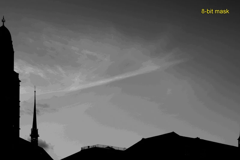

Although @D Fosse already mentioned this, I feel it is important to emphasize once more that Photoshop's 16/32bit per channel workflow is severely hampered by selections only being 8-bit. High-bit depth data is immediately destroyed when selections are used by a client to create masks. Basically they are working with 8-bit data in selections that wreck a high-bit depth image more and more as more selections are created and layer masks based on those 8bit selections are introduced.
And people are surprised banding occurs...!

Are you showing is a mask or the edits of the high bit data 'under' the mask? And what edits?
And of course, there are masks in Adobe's raw processors.
There are very very few true 16-bit capture devices, and again, no matter; Photoshop is 15+1 bits, always has been. The test is to illustrate data loss and banding, editing on any high bit data.
