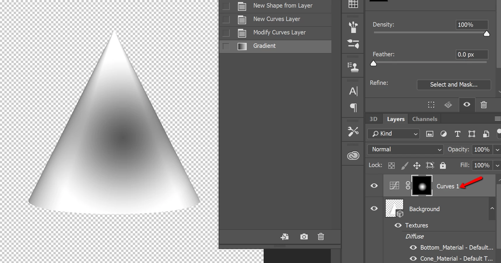

I'd like to use a curves adjustment projected through a layer mask onto a 3d model.  I can get the effect I want in the 3d window using a masked adjustment layer, but when I merge the adjustment layer down onto the 3d layer, the effect disappears.  Thanks for any help!

    Thanks for the quick response!  Here's where my confusion comes in...

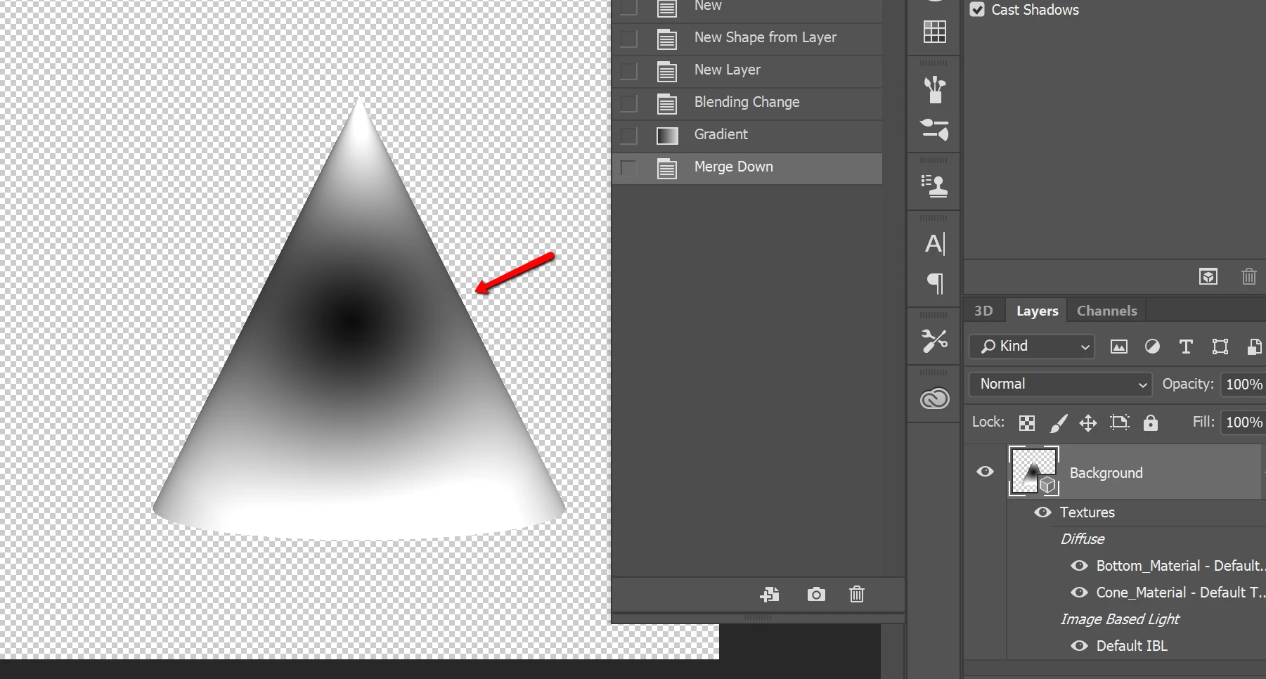

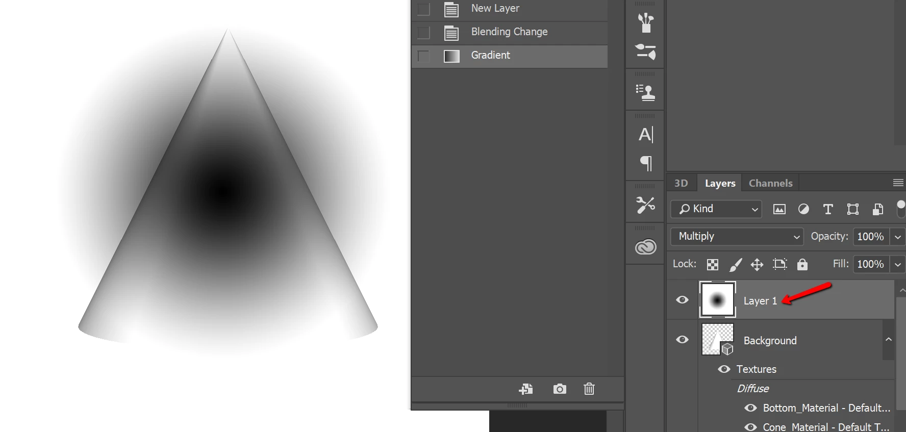

    I can make a gradient on a layer and merge it down onto the model...

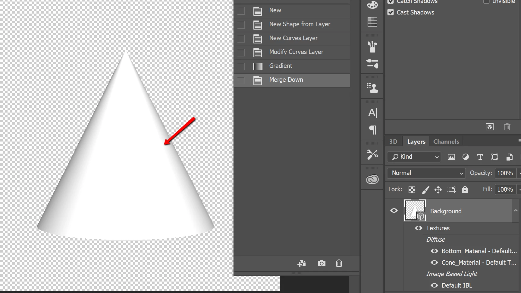

    But if I try to get the same effect with a masked curves adjustment layer, the effect doesn't drop when merged...
    I'd like to do this in 3d and not 2d space as the model I'm working on has multiple textures mapped to it and I want to apply the effect seamlessly across border edges.
