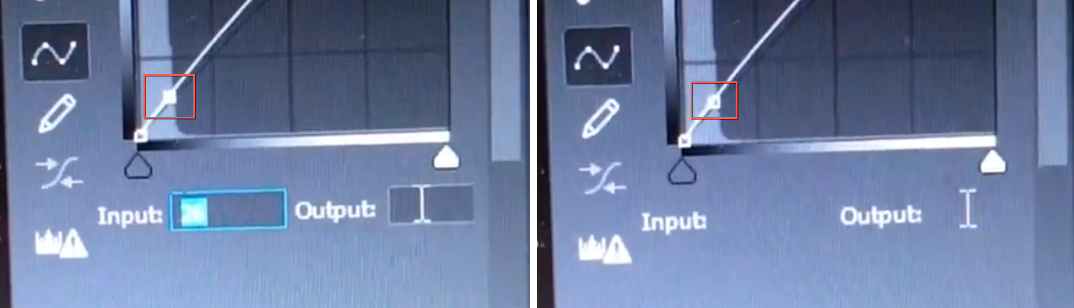

Hi, I just signed up for photoshop and I'm in my 7 day free trial period. Are there certain tools that are disabled during this trial period? I'm having issues with certain things not working.

I was out of my office, and have just now looked at it. In my my first screenshot from your video, note that the square is solid. In the second, it is hollow because it has been deselected. This is normal behavior when no markers are selected.
Click on the marker to select it and your numbers should return.

Thanks so much for taking the time to look at and help with this issue. I do understand what you are saying. The issue is, and if you'll kindly refer back to the video in the last few seconds, with the marker selected I click in the output box to enter an output value and both the input and output boxes go away again.There is no way to enter an output value.

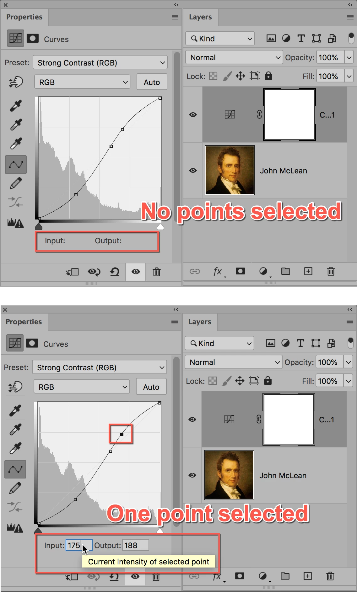

I've watched your video a couple more times, and I cannot reproduce it here. I have a few more thoughts (below), then I might be out of ideas. I can type into the Output box every time, no matter how I approach it.
  • In these two images above, there are five points. In the first, no points are selected, and nothing can be typed in. In the second, one of the five points is selected. What happens when you reselect your point that is not selected at the end of your video? Can you then type into it?
