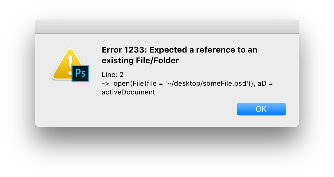

LukasJuskonis
June 19, 2018
Hey, when I'm trying the script I get a problem message :
Kukurykus
June 19, 2018
I guess you didn't use your own path with your file at the end of but remained that I used? If so you need to at least create a .psd file that you will name someFile and then save it on desktop.
