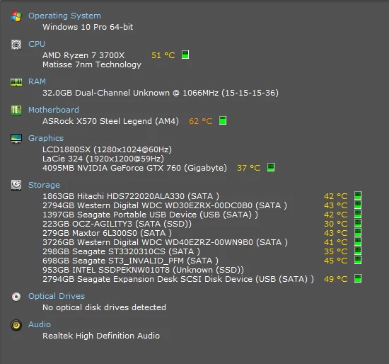

I have installed Photoshop 2021 and also have 2020 installed via Creative Cloud. Although it is not on my Windows 10 'open menu,' 2022 is available from the CC  Desktop.
Anyway, prior to 21/10/2020, Photoshop 2020 was running fine.
Having now installed 2021 and 2022, the programs open, but when I try and open ANY file type, it simply shuts down without giving any error or warning message.
Basically, I cannot open or edit any file.
I can create a new file, but even then when I try and open a previously saved file, it still crashes with no warning message(s.)
I can also save, open and re-edit the file I crteated within Photoshop, but when I attempt to open another previsoulsy saved file, it crashes.
I have turned off Graphics Card Accelaration in Preferences and have updated to the latest Nvidia Graphics driver, so none of these suggestion were any good for me.
I'm forking out £120 a year for this and lightroom and expect it to simply work.
Below are the specs of my system, so it is more than capable of running this program.

Hi
Adobe have basically rendered GPU's older than 4 years useless with this update and I'm afraid your GPU was released in 2014
You can see the GPU FAQ here
https://helpx.adobe.com/photoshop/kb/photoshop-cc-gpu-card-faq.html
Unsupported graphics cards
If your graphics card is older than 4 years, GPU functionality in Photoshop may be limited or not supported.
You could try resetting your PS preferences

October 22, 2020
Hi Greg.
As I mentioned in my original post, I have re-set both Photoshop 2020 & 2021 so that neither version uses the Graphics processor, and they still cannot open any files
The program merely shuts down with no warning message(s).
I realise that Adobe want to get the best out of the software, but does this mean that when every every Graphics Card reaches it's 4 year 'expiry' date, it can no longer be used in Photoshop?
