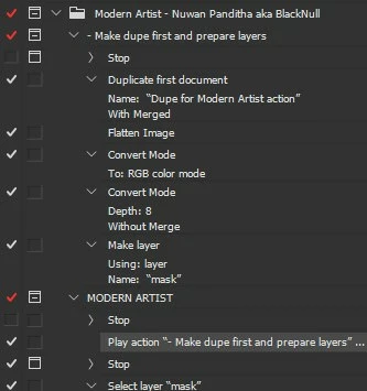

So it would be wise to add a whole subaction to both these actions that makes a duplicate and sets things up correctly, with or without some pointers.
Zesty_wanderlust15A7
June 14, 2022
I've added this subaction and a stop with instructions to both main actions...

Look at the expanded action step.
Do you have a selection active?
Is the action trying to select a named layer that isn't in your file? Is it trying to select a Background image layer that your file does not have?
