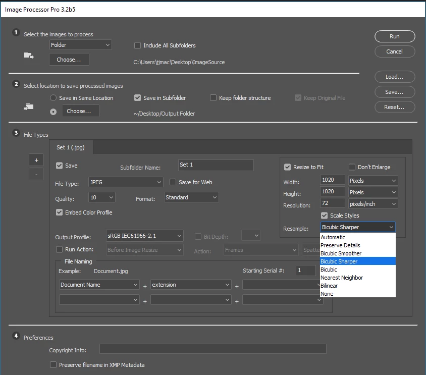

Use Photoshop Plu-in Fit Image halever it will not use Bicubic Shateper it uses Bicubic.
Menu File>Automate>Fit Image ... set in 1020 for both width and height.
The Max side will be 1020
Or Install Image Processor Pro Plug-in you cans set in 1020 for bothe width and height and set Bicubic Sharper.
