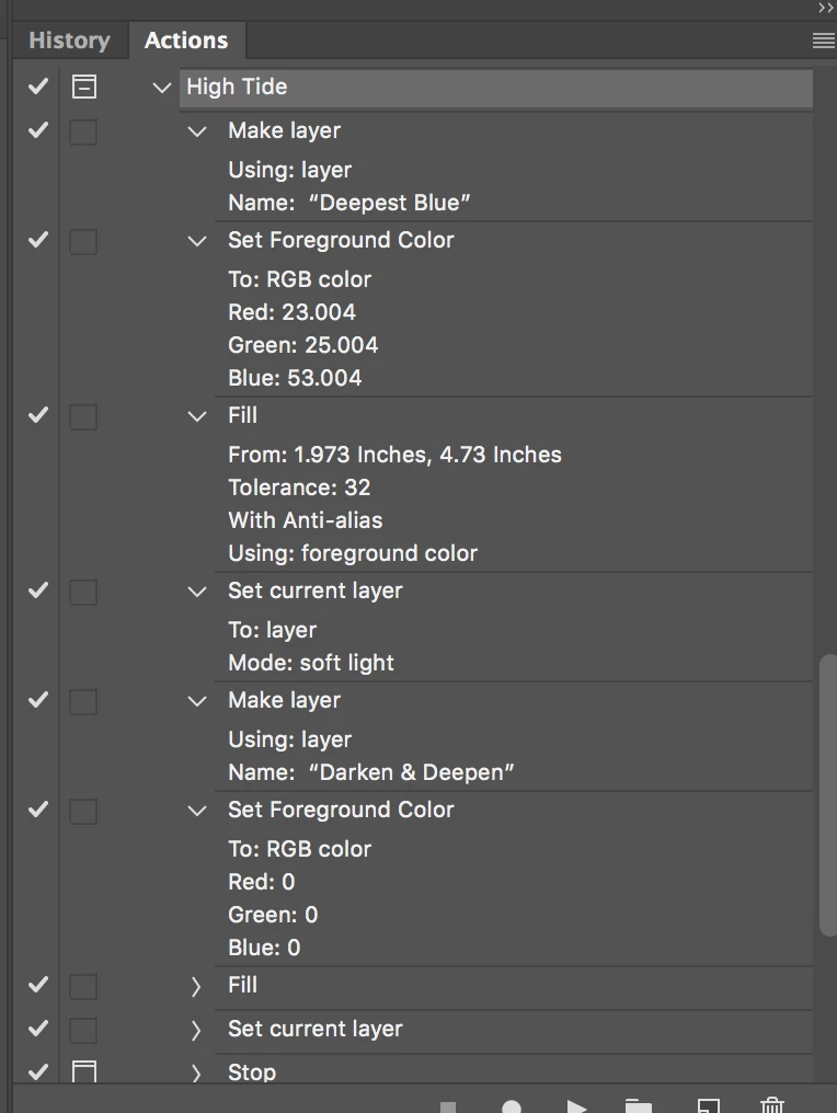

Hey, all,
I created a set of Actions using the Photoshop CC 2017 version.  I have had several friends with the same version of PS test my actions and on the layers in which I used the paint bucket to dump a color over the photo with the blend mode in soft light, are just coming up as empty layers for them, i.e. no color.  The really frustrating thing is that it works perfectly for some, and not at all for others, and I can't figure out how to fix it.  Please help!

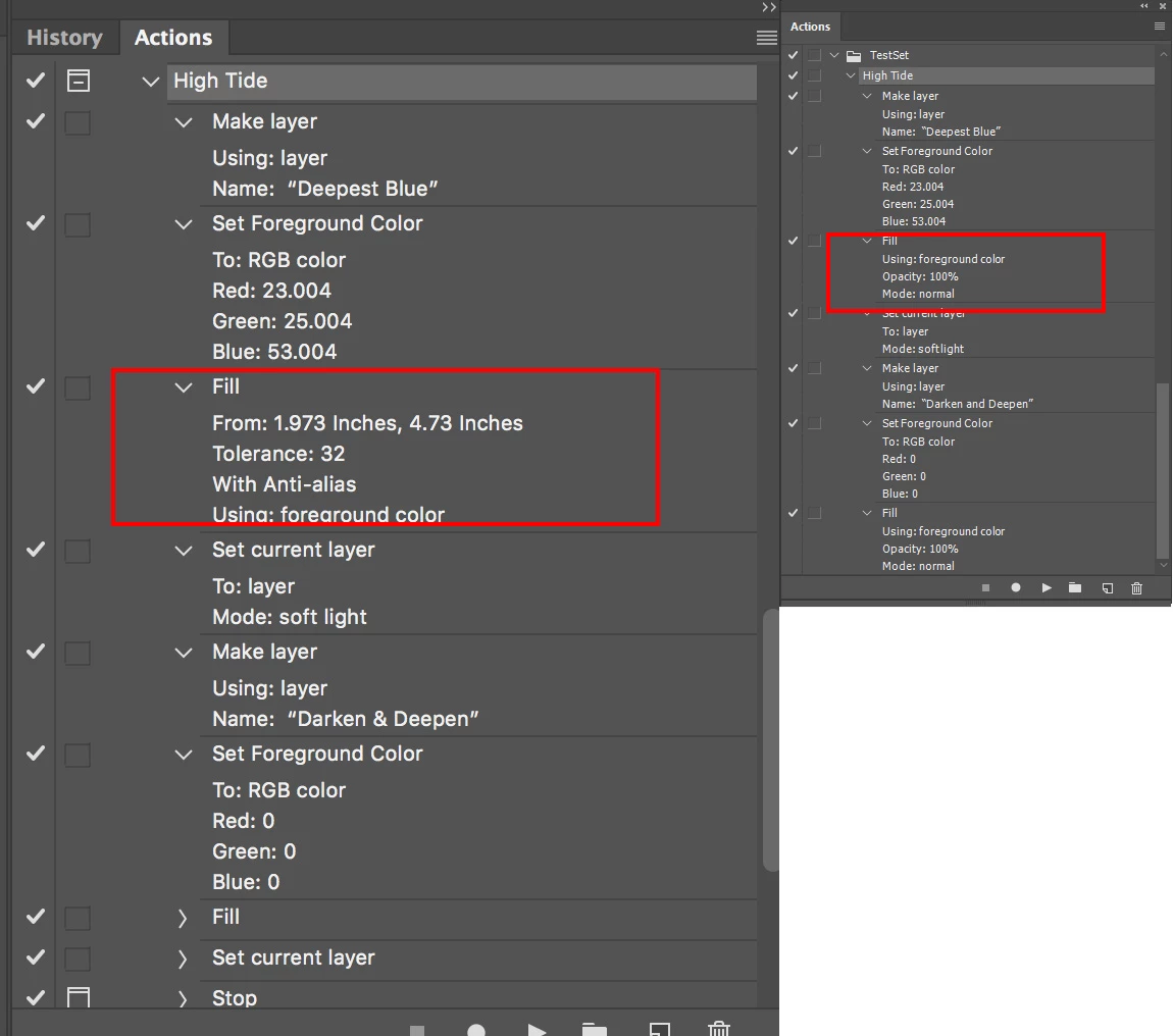

Correct answer Stephen Marsh
I’d just use a solid color fill adjustment layer.
jennsummer
February 12, 2018
Thanks, guys! The way I was doing the fill was the problem. Appreciate the help!
JJMack
February 12, 2018
After you record an action you should always ecpand the action fully and read what has been recorded and edit step steps the may cause problems.  It is also a goou idea to test the action on some test doculemts. Single step through the action watch each step execution.  When satisfided it is good save the action set for safe keeping.

February 11, 2018
I see you are scaling Photoshop's UI 2x.  That what you posted is onle part of the action with some of the steps expanded.  The first thing  I see that look like it could be a problem is the expanded Fill step.  How did you record that step?  I was expecting you to have recorded a  simple menu Edit>Fill instead you use the Paint Bucket tool and touched a point  nearly 5" into the canvas.  Depending on the document Size and resolution  the action is plated on that could potentionally be a problem.  Post the resy of you action seo we can see it. If you use the paint bucket click in the top left cornor of the document recording the step.

February 11, 2018
Please post  your Action.  If you can save the action set and upload the .ATN file an post a link to it.  If you don't want to do that capture the Action pallet with the action set steps fully expanded so we can see what you recorded in you action.  We need to see all steps. Most actions have some dependences they will not work on every document you play them on.,
