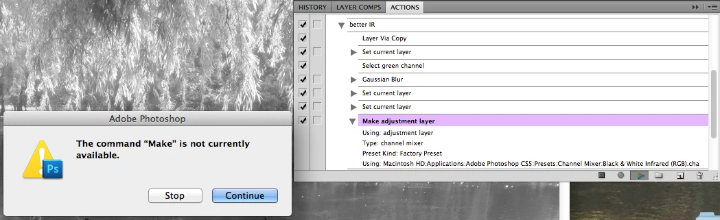

CS5 Mac OSX
I am making an action that uses an adjustment layer. when I go through the process without recording the action it woorks fine but when I record it the action always stops at the Make adjustment layer step with the error 'The command "Make" is not currently available.' I tried inserting that step through the adjustment layers panel, from the bottom of the layers panel, clipped and un-clipped, but I can't get it to work. I made a test action with only the make adjustment layer step and that worked but when I copied the step into the real action it broke again.
how can I get this action to record?

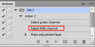

Like others have stated, you must have the RGB channel selected in order to make the adjustment. You can reorder the actions if you habitually do this after making the adjustment and the action will run.

Looks like from the steps in your action that the green channel is the only channel visible.
You probably need to put a step in your action to select rgb channels  to be able to add an adjustment layer in action.

That makes sense, but if I select the rgb channel, before I go back to the layers panel to add the channel mixer adjustement layer, it changes the picture in a way that i can't use. I need it to stay black and white from the channel selection, not rgb. does that make sense?
! - I found a workaround that includes doing my changes in the green channel then making a selection of the page and copying what it looks like and pasting a new layer of that and deleting the one with the actual green channel changes and moving on from there. the adjustment layer works after that. so i think you were right about the channels. this is far from ideal but it is in an action now so i am ok with it.
