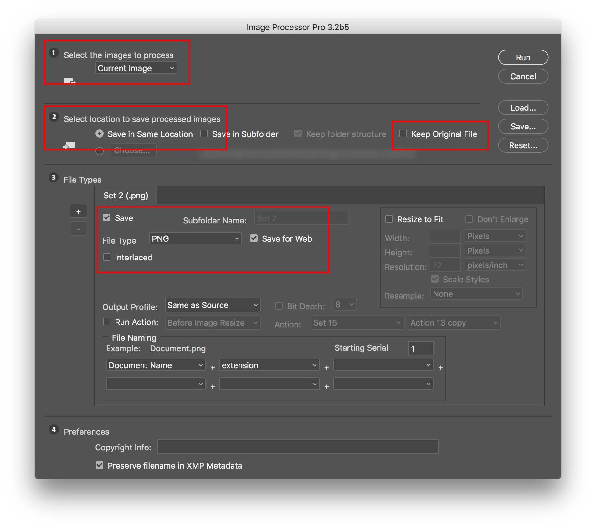

Correct answer Bojan Živković11378569
There is already correct answer by Stephen, I will add my $0.02. Below is how configuration should look like in Image Processor Pro. I have highlighted important areas. There are and other options but lets skip them. Your files will be saved as filename_01.ext without any additional setup which can be done inside IPPro window, lets skip and that to avoid confusion and too much info.
I have tested with Photoshop CS6 and version of Image Processor Pro is in the top left corner.
And by the way, do not record any additional step, I believe I know which action is in question. You do not need save step, just steps to insert path, transform path with modal turned on, make selection from path and crop image based on selection and lastly to set selection to none (optional step).
March 16, 2019

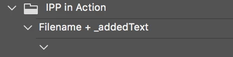

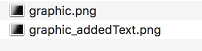

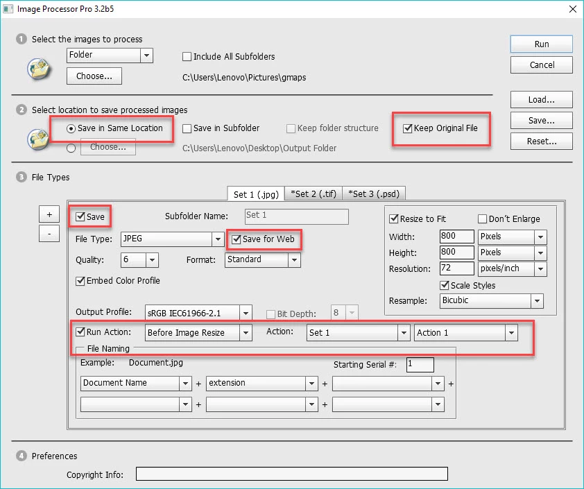

Stephen Marsh
March 15, 2019
I would use the Image Processor Pro script.
There are two options… First and foremost, it is a batch processor and it can also use an action (not sure how it would go with your manual crop step).
Secondly and less obviously, you can record it into an action as a single step (the step will be shown as blank but it does work), this will allow you to save for web into the source directory from within your action.
In this example, it saves a copy to the source folder with the original filename and an added suffix.
Although I don’t like saving over the originals, it can be configured to do so and be used in lieu of a standard save step (you would need to add steps to the action to close the current file without saving as IPP has handled that):
