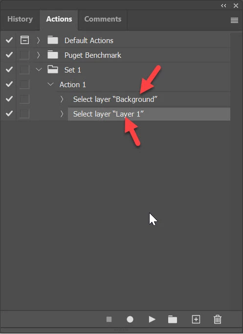

I have made available some Actions which give enhanced filters for Photshop.
An Italian person has written to me saying that they don't work for him because he has an Italian version of PS.
He tells me "Select layer "Background"" and "Select layer "Background Copy"" have a problem because in my PS is "Sfondo" and "Sfondo copia" so PS cannot find the layer, and I had to record again the 2 actions".
And also  "I can't find a fix for this issue: the actions "Hide Background" and "Show Background" don't exist."
Is there something I am doing wrong when I record my actions? Otherwise is there a workaround for this?  Fortunately, I have made these filters available for free.  But it does mean that I could not sell future actions even if I wanted to, because I couldn't guarantee that they would work on all versions of PS.
Correct answer c.pfaffenbichler
As for selecting the Background Layer try using
As for selecting »Background Copy«:
If a Layer needs to be selected again later in an Action it should immediately be renamed upon creation, if possible with a unique name that is unlikely to conflict with any existing Layers.

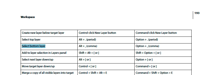

So, I have now looked at the default Actions provided with Photoshop.  (I didn’t think I need to before because I didn’t think producing my own Actions would be so tricky.)
What I have noticed is that often the first step is to copy the current layer and thereafter all processing is performed on that layer or copies of that layer.   I had to learn one thing before I could emulate this.  I learnt that I could merge a subset of layers by selecting them and clicking ‘Merge Layers’.  Before that I was using ‘Merge Visible’ and I had to go to ‘Background’ to make that layer non-visible.  This I could do using Alt+[comma], but that key press was only recorded if I actually used it to move to the bottom layer from another layer.

August 3, 2022
You must avoid hard coded names which always comes inside parentheses in action step. That will break action when played in non-english or non same language application because Photoshop will look for hard coded name. It is wise to avoid clicking on layer to select it whenever you can esspecially when you are not controling file from start to the end. It is good idea to inform user through stop what is requirement in order to sucesfully play action.
If you want to allow user to play action on layered file then check every possible situation and decide how to record action but also how to inform user what is requirement to play action.
