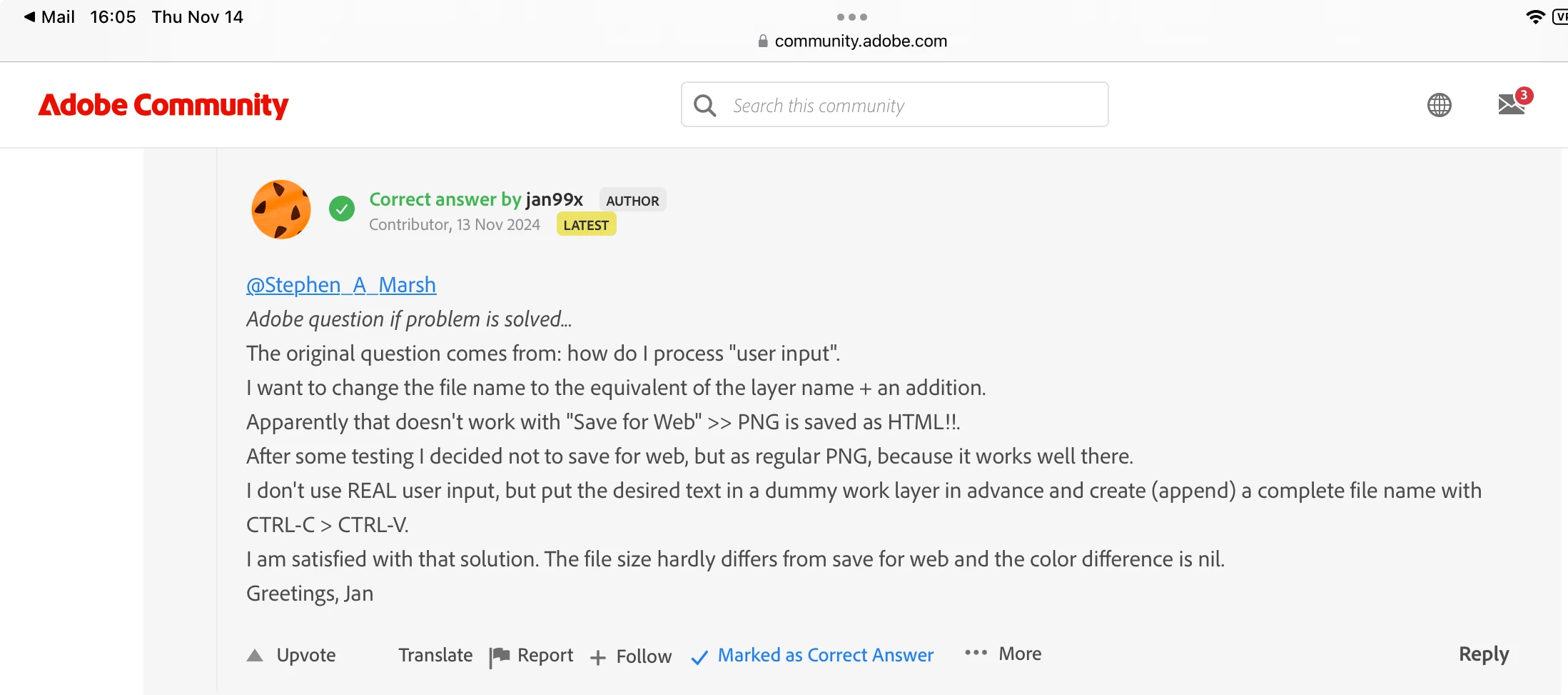

Oh yes, help, you're right, I made a mistake, sorry. I'll put the text in the right thread here.
Adobe question if problem is solved...
The original question comes from: how do I process "user input".
I want to change the file name to the equivalent of the layer name + an addition.
Apparently that doesn't work with "Save for Web" >> PNG is saved as HTML!!.
After some testing I decided not to save for web, but as regular PNG, because it works well there.
I don't use REAL user input, but put the desired text in a dummy work layer in advance and create (append) a complete file name with CTRL-C > CTRL-V.
I am satisfied with that solution. The file size hardly differs from save for web and the color difference is nil.
Greetings, Jan

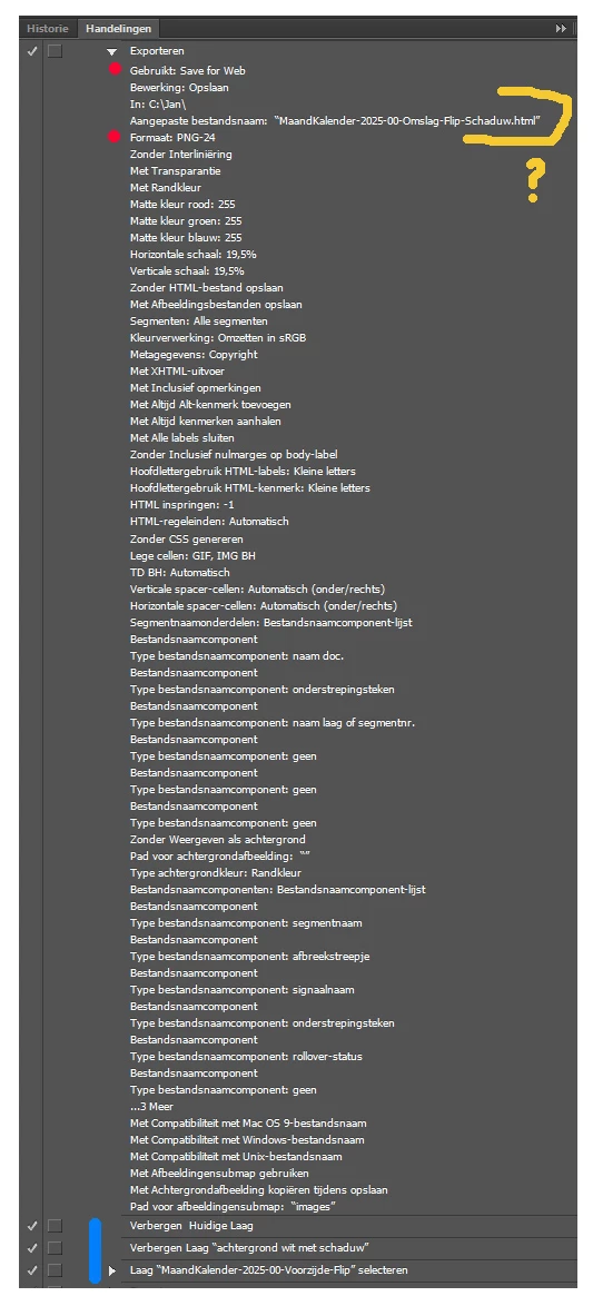

PS doc has layers, each layer wanted to save as web.
In the image example ... the exploded view of the step: Save for Web
Note: before starting the action I set the save for web settigs to PNG by hand.
colors in image:
red = set to PNG
blue = next layer
yellow >> do not know why it is HTML

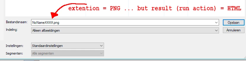

In the meantime, I am one step further in researching the problem...
The problem arises when I go to the Save for Web window and change the file name there (NOT the extension!). As soon as I change that with a cut and paste of the PS layer name in question, the problem arises. The file will then receive an HTML extension. That is not the intention, but it is also not correct for the contents of that file ... if I later manually change the extension to PNG, it turns out to be a correct PNG file.
So: when I record the action, everything works fine...as soon as I play the action the HTML extension appears.
The problem lies with cut and paste in the file name in the Save for Web window....how to solve that?
