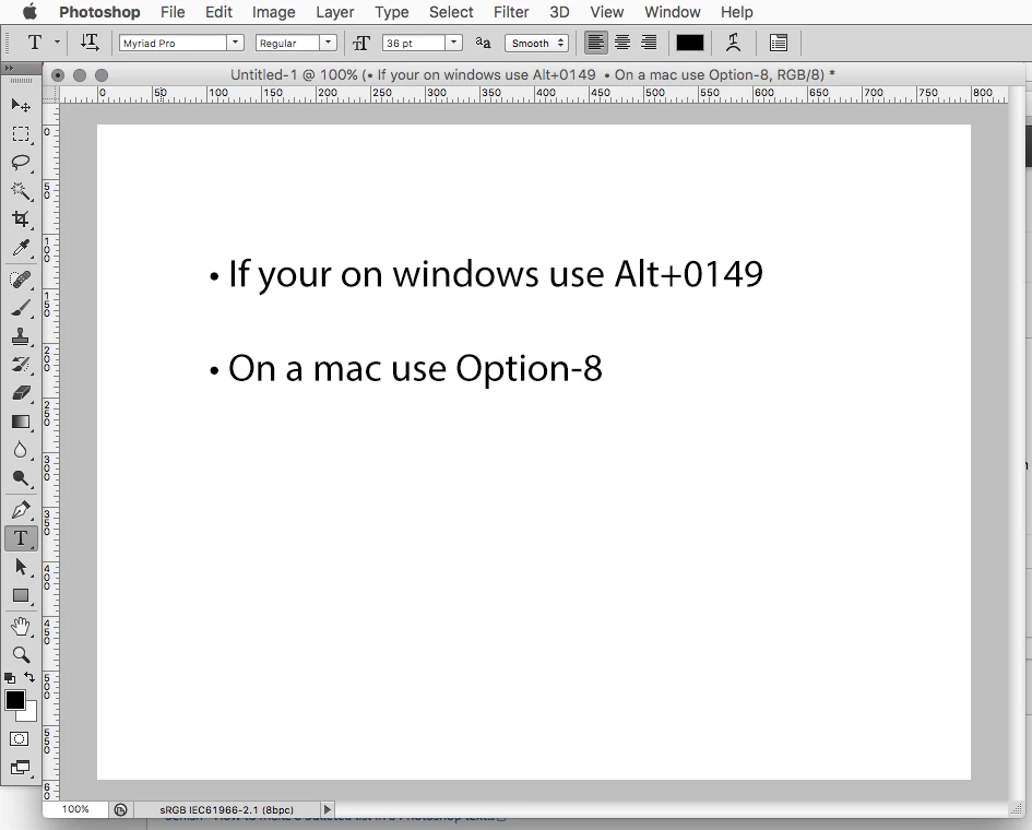

Jeff Arola
February 28, 2016
Put the cursor at the beginning of the line of text
and
If your on windows use Alt+0149
On a mac use Option-8
