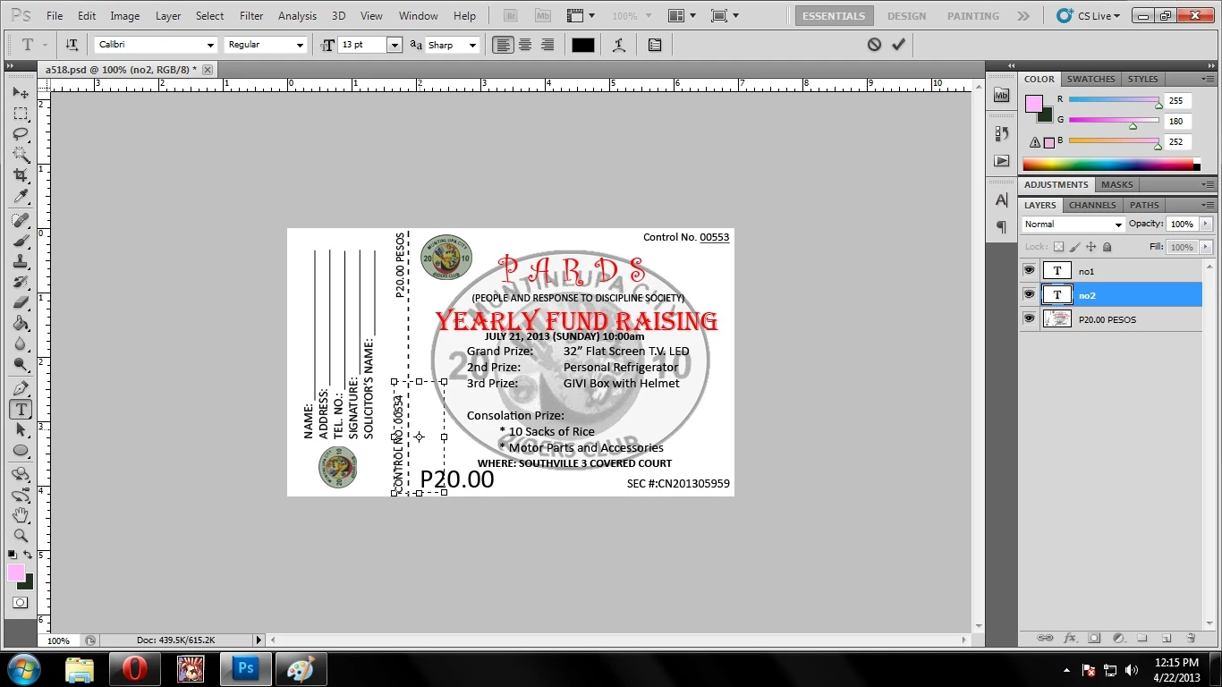

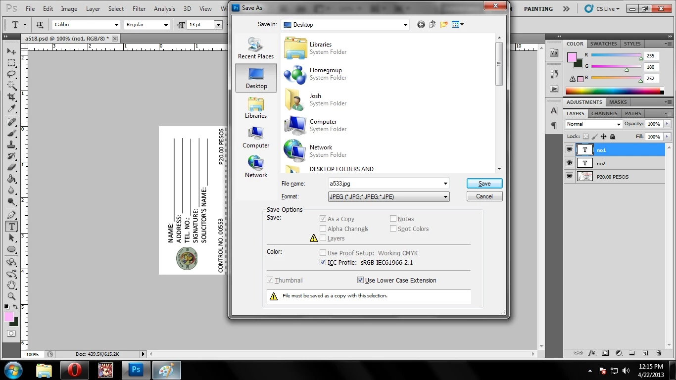

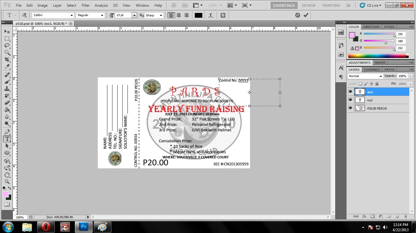

Hello guys, I am on a project of making 12,500 tickets and so far, I'm at 500 out of 12,500 .. -_-'' I was just wondering if Photoshop or other Adobe programs can Add Sequential Numbers on a particular area ON a picture,
Example: (this is what i 'm doing, i'm doing it manually, saving it one by one.. and it is taking some time, it's been 2 days already)
then..
and..
and repeat the process again ..
there.. i've tried using recording Action but it didn't help me.. T.T also i don't have any idea on how to use script, (if i have to use script, can you instruct me on a step-by-step procedure or atleast pinpoint me to a thread that explains it, because the ticket's deadline is on May 4th, and again i have 12,500 tickets to make)
also the way that i print this is first as you can see saving it one by one as .jpeg and selecting 9 of the .jpeg files, right click, then print as wallet size, for it to fit in a 8.5 / 11 paper.. there..
Thank  You guys in advance and please i'm desperate!
