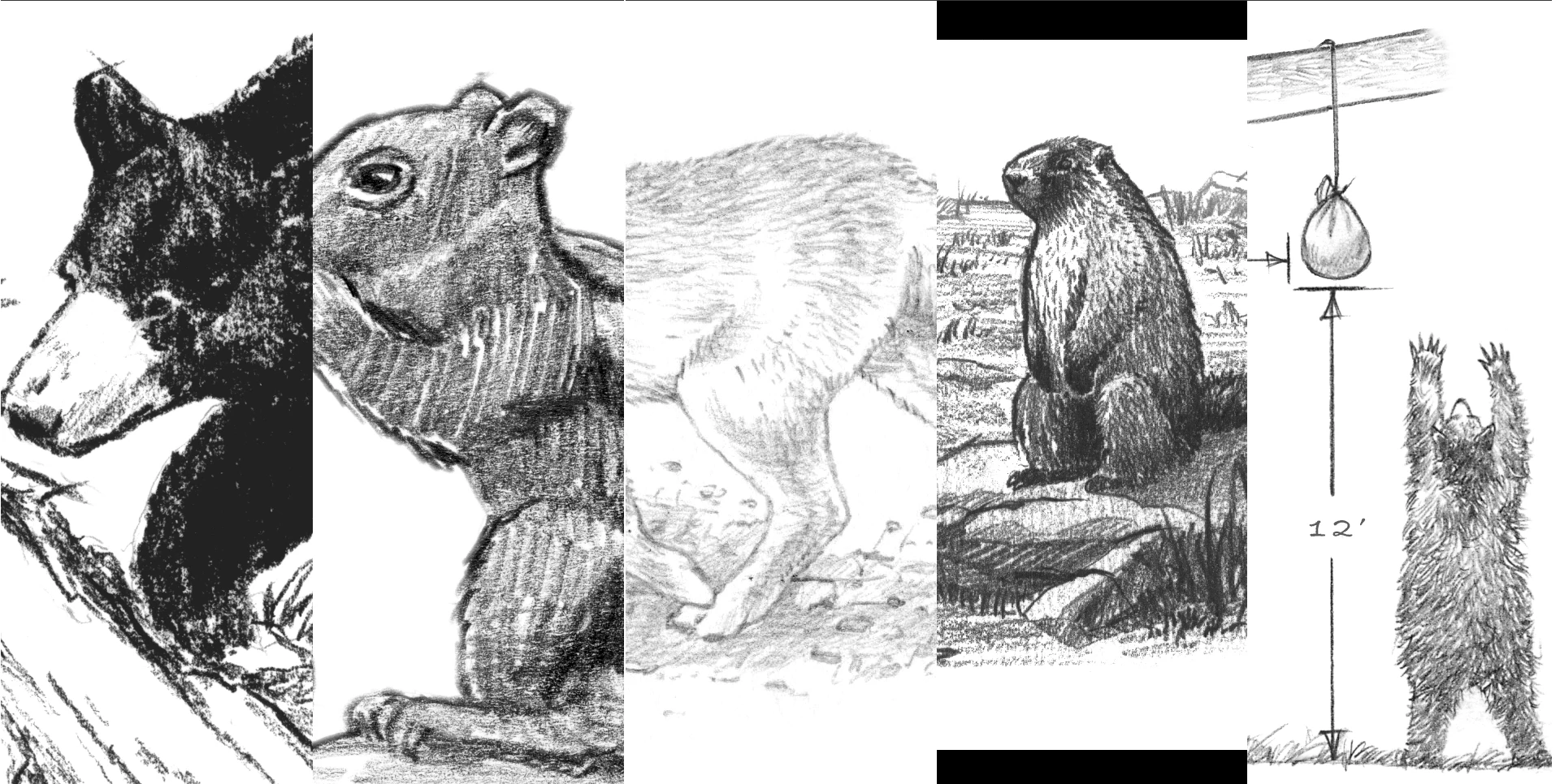

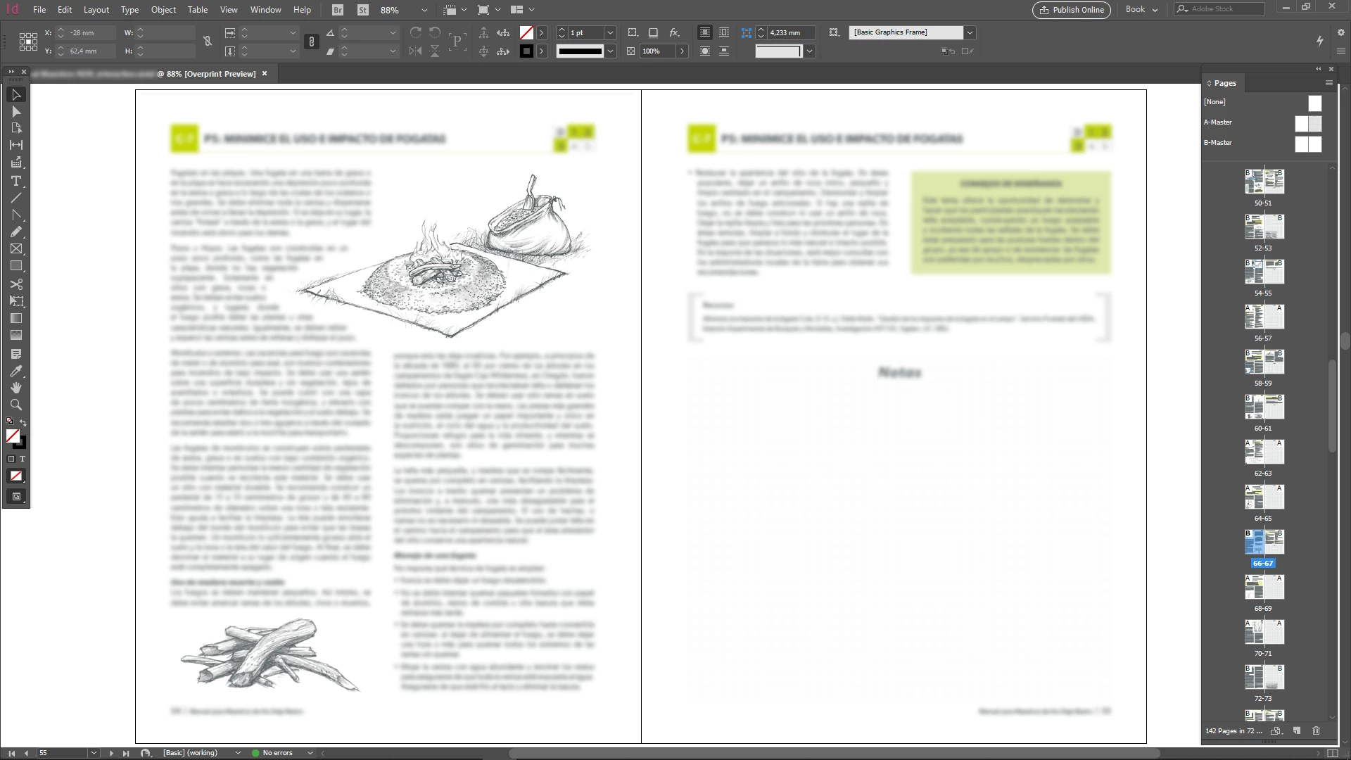

Hi all, I really appreciate your time an thoughts; here an example of some of the dozens pictures I have and the Indesing screen. I'm pretty much forced to use grayscale due to printed project is based on a 2-tones Pantone. And as far as I know mixing CMYK for a 'strong' black only combining 40-60% cyan + 100% black; adding more inks turns to dirty brown and printer will not be really happy: innecesary ink use and extended dry time. I do understand each drawing has it 'nature' and it would have been simpler if all of them came from the same hand; but this is a re-re-edition case...

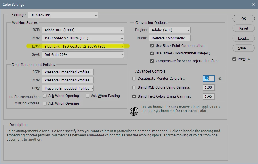

Load your InDesign document’s assigned CMYK profile as the Color Setting’s Gray Working Space as @D Fosse is showing. If you make a conversion to Grayscale either via Convert to Profile... or Image>Mode>Grayscale the Black Ink version of the CMYK profile will be assigned to the image. You can then color correct the different grayscales to match.
Save the files as .PSDs—embed the profile when you save in case you want to make additional corrections in the future. InDesign will ignore the Gray profile and display the grayscales on the CMYK black plate—you’ll need to turn on Overprint Preview in order to get a color managed soft proof of the grayscales.

Photoshop lets you create Black Ink profiles from your destination CMYK press profile, which can be used as the Gray profile for grayscale images. If you search the forums for Black Ink profiles there are a number of posts on how to create and use them.

Setting up that profile in Photoshop Color Settings is very simple: click "load gray" under working gray, and navigate to the CMYK profile you want.
When it's set up like this, the black ink profile becomes selectable everywhere, including under "convert to profile" and "assign profile".
