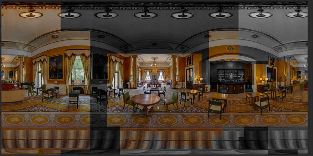

I've been having ongoing problems with adjustment layers becoming corrupted and not displaying properly. After working on an image for a while - it never happens straight off - one or more layers will appear as though the mask on the adjustment layer is made up of 'blocks', either hiding or showing the adjustment layer. Please see the attached screenshot to see the problem.
You can see that the 'blocks' also appear on the adjustment mask themselves.
If I zoom in, the blocks on the mask will disappear, along with their effect on the image itself, and the masks will display as they actually should do. But, when I zoom back out, the blocks reappear.
Sometimes the pattern of the blocks will change when zooming back out; sometimes they stay the same.

Does turning on (or off, depending on the current settings) Photoshop > Preferences > Performance > Legacy Compositing and restarting Photoshop have any bearing on the issue?
Does turning off »Use Graphics Processor« in the Performance Preferences (Photoshop > Preferences > Performance > Graphic Processor Settings) and restarting Photoshop have any bearing on the issue?

Thanks for the suggestions. Legacy Compositing was turned on as was Use Graphics Processor.
I'll give both options a try over the next few days and see if they make any difference. One other annoying thing about the problem is that it is intermittent, so it may take a little time to track down what is causing the problem.
I use to suspect it was a GPU related problem, but the fact that it has happened with two (very) different GPUs has sort of ruled it out, in my mind anyway. Could always be wrong.

To make sure try disabling Photoshop’s GPU usage.
