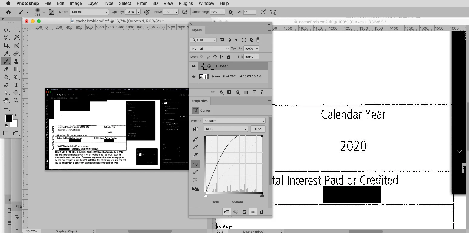

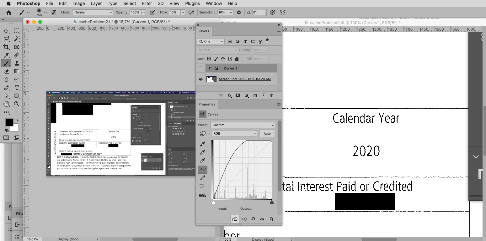

Apparently you scanned a bitmap and converted that to grayscale. So there are only black and white pixels, no gray ones.
So vertain adjustments may seem to have an effect at magnifications below 100% but actually they DO NOT.
Each of these screenshots show the same image twice – at 16,7% and at 100%.
Once a Curves Layer is active, in the second screenshot it is hidden.
Note that the type in the image is unaffected at 100% while at 16,7% is seems to get darker or broader.

Yes - that is exactly what is happening.
And you say that this is becasue, while my image is a grayscale as far as PS is concerned, it only has one color, solid black, "000000."
And the reason I think I see adjustments when zoomed out is becasue PS uses those "Stand Ins" that you mentioned above to reduce the resolution in the view only to make it load faster.  OK, I get it now.

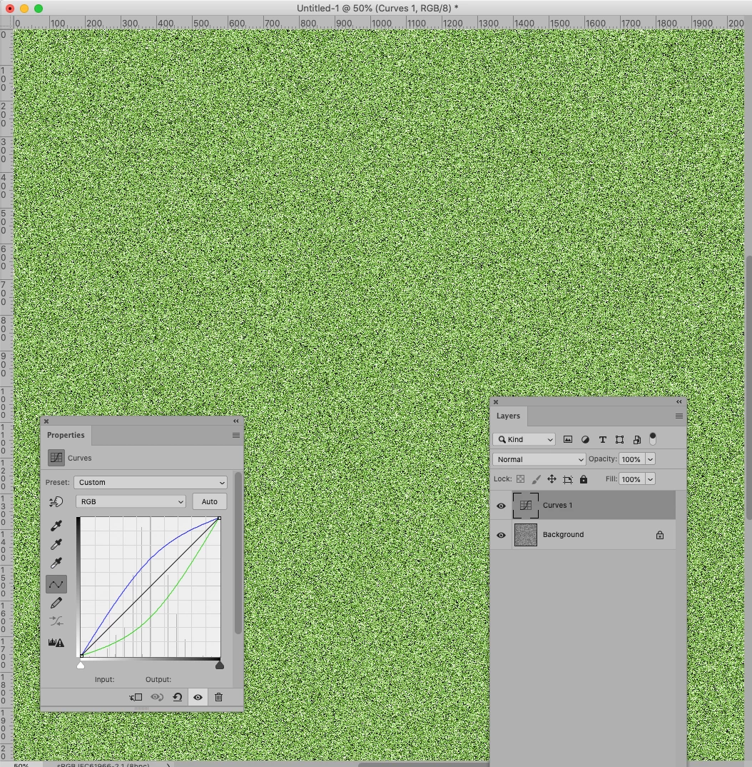

See these screenshots taken of the same image at 50% and 100% magnification.
