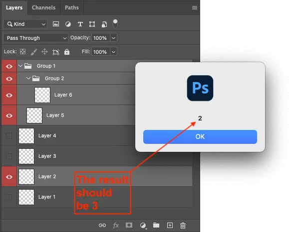

There is no native method that I am aware of, perhaps there is some AM code... All of the ways that I know rely on "hacks", which is sometimes all that we have.
https://gist.github.com/hilukasz/03b17ee78414aadff995
This script dupes the selected layers into a temporary doc in order to count them. This script does not include any selected layer groups in the count, it is not bulletproof in my tests with nested groups inside groups, so YMMV:
selectedLayersLength();

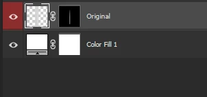

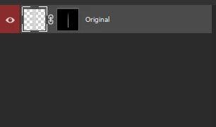

Situation 1
Just one layer with a layer mask
Situation two
One layer with layer mask, one solid color layer on the bottom. The target layer will not always be name original either
Situation 3
One text layer, one image/artlayer, one solid color layer.
