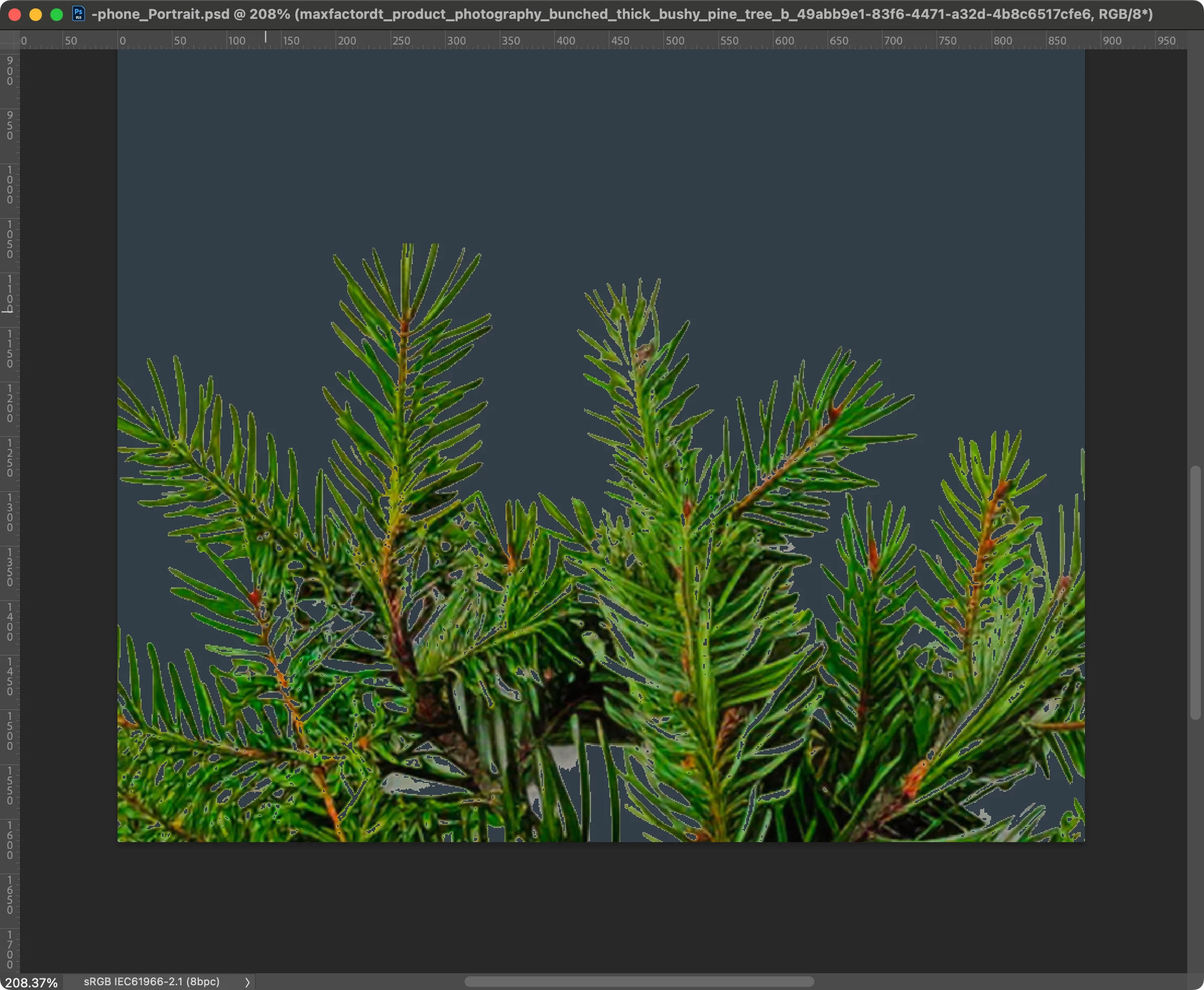

Well, here's one using layer style blending options. I've also tried using color range and select subject with magic wand work. I just can't seem to get up to their edges without chewing out the middle, and it's too narrow and intricate for me to core back in.

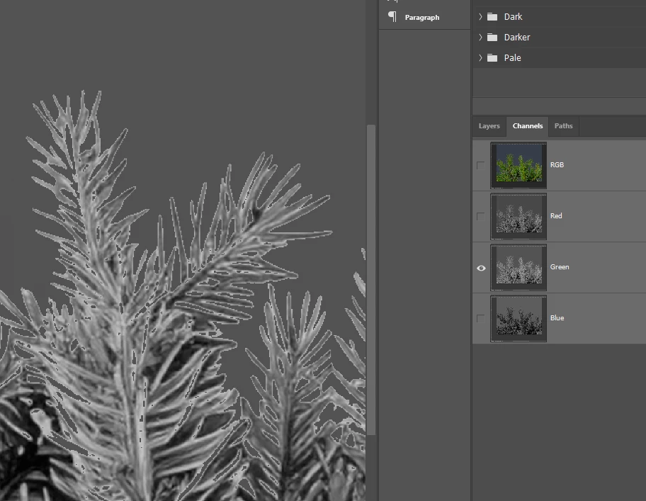

My first thought was to see if I could adjust the image to increase the contrast between the subject and the background. People sometimes use Channels for this – go to the Channels tab and turn off all but the Green channel. That creates a decent contrast you can start with.
It’s still a little fuzzy though, there is green in a lot of the image. But channels can sometimes get you closer.

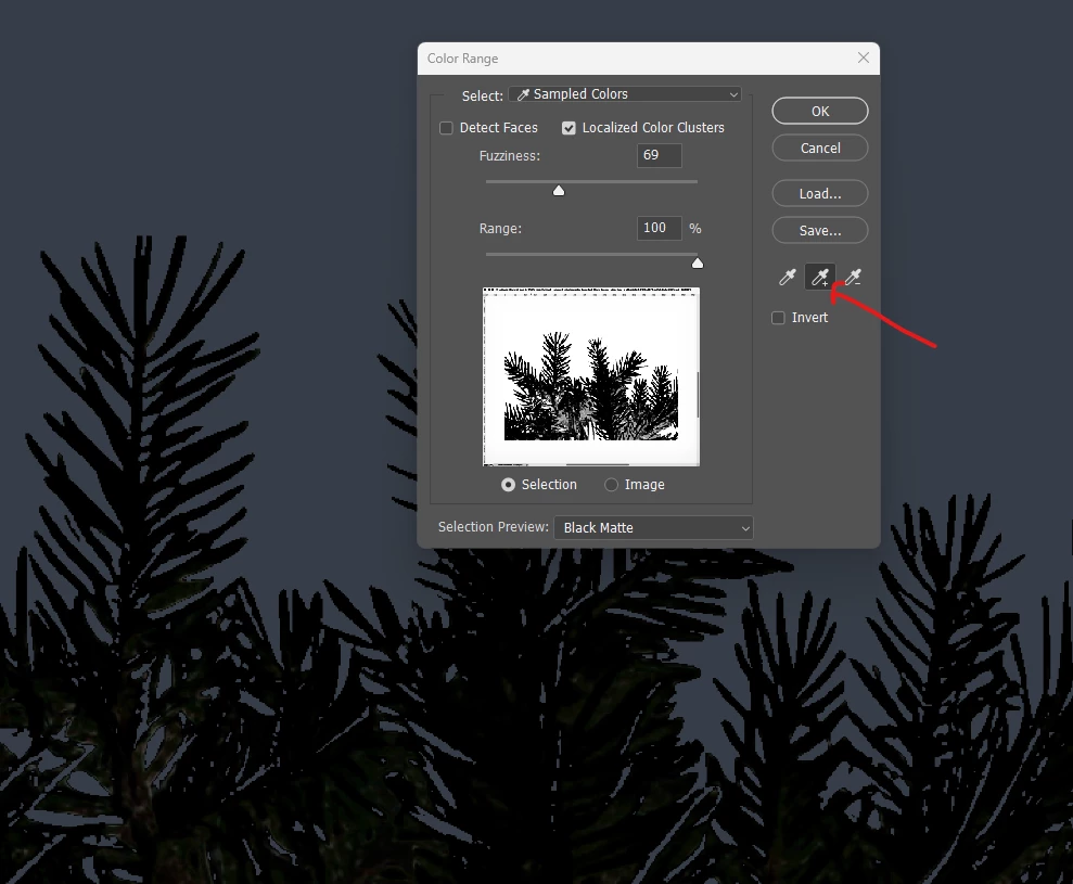

Next, I tried Select -> Color Range. In the Select Color Range dialog, there are three eyedroppers on the right. The left-most will pick a single color to select, and the sliders can be used to make that color choice "fuzzy". The middle eyedropper has a plus sign ("+") and the right-most has a minus sign ("-"). I used the left-most eyedropper to reset the color selection by clicking on the background. Then I switched to the "plus" eyedropper, and selected all around the image anywhere there was background color showing through, and up the edges and top of the image to pull in all the shades of the background color. When you're done, hit OK, then go  into "Select and Mask" (if that's not showing, pick a Selection tool like Quick Selection) and fix any parts of the selection that aren't right, such as the middle, darker branches that may have been selected inadvertently.
My result is below.
