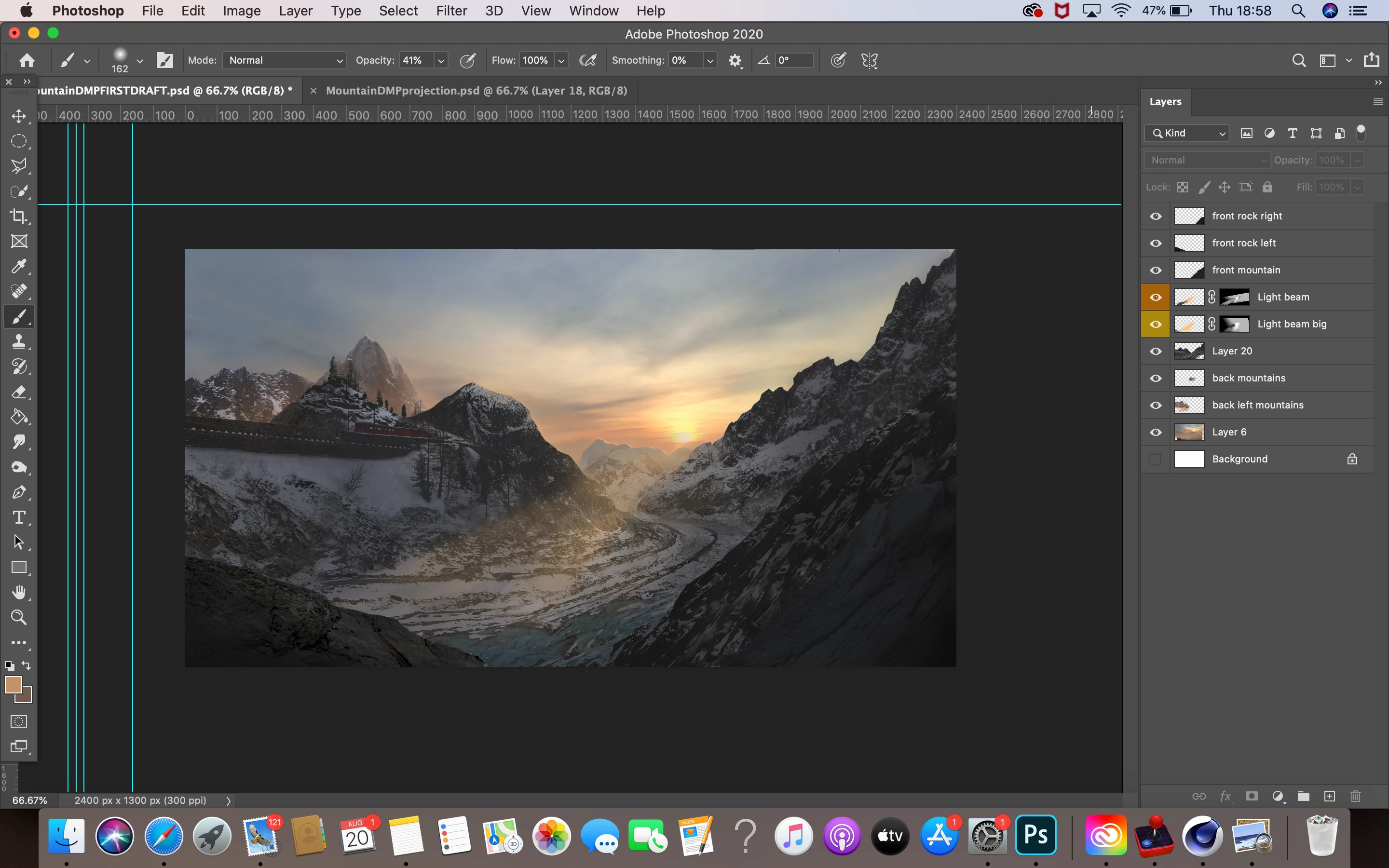

Hi everyone,
I have this photobash file here that i've been working on:
I'm about to transfer this into cinema 4d to learn how to create a short projection. I've already made sure the layers continue past what is seen here, as the camera track will move the perspective, but I'm unsure how best to split up the main bulk of my composition (layer 20). I'm also not sure what to do about the light beam, i'm assuming I'd keep that seperate rather than apply to all the layers?

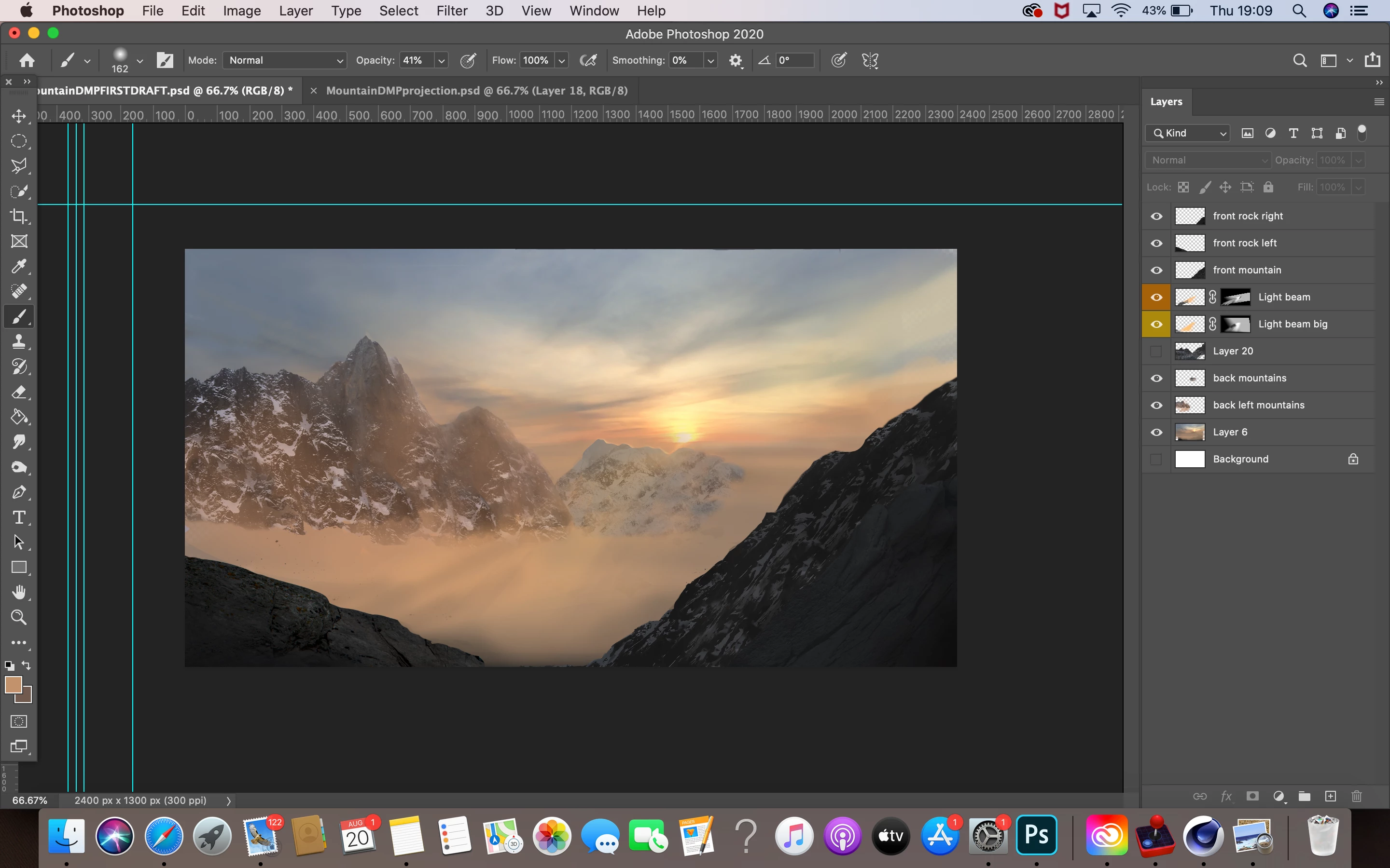

Here is what the image looks like with layer 20 hidden. It would also be helpful to know the best file format to export each layer, I was assuming .tif?

Hi
I don't use Cinema 4D but when I do this with Blender I tend to split the image into just a few elements, project them onto planes then run a test animation on the render camera. It quickly becomes apparent which parts of an image need to be on individual separate planes. So more of an iterative process rather than trying to pre-empt it all from the start.
Definitely keep your light beam separate as it will become very obvious if it bends at any point.
As long as the format you choose supports the bit depth you want to use plus transparency (so TIFF or PNG) you should be fine.
Dave
