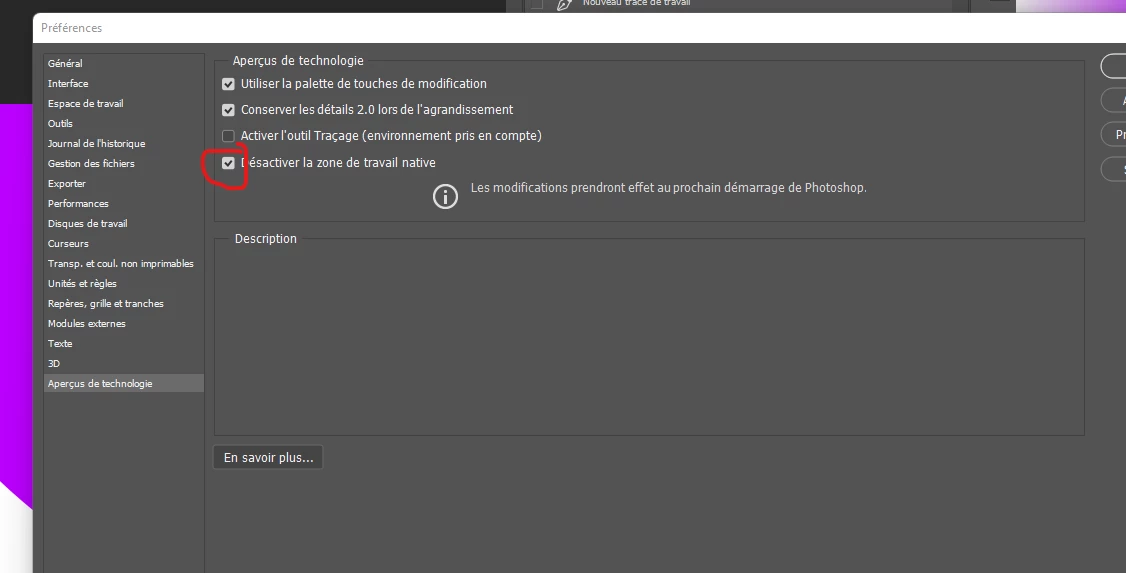

Two things to try:
  1. Go to preferences > Technology Previews... and check "Disable Native Canvas" - then restart Photoshop. Does the problem still occur?

Merci infiniment sa marche.
J453Correct answer

Two things to try:

Thank you Jeffrey, I had the same problem and fix it with "Disable Native Canvas" 😃
