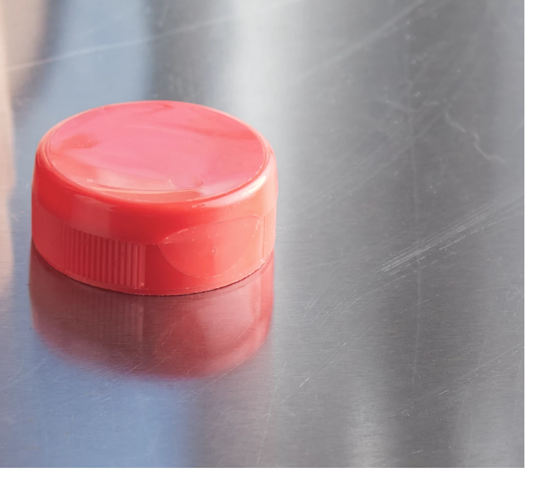

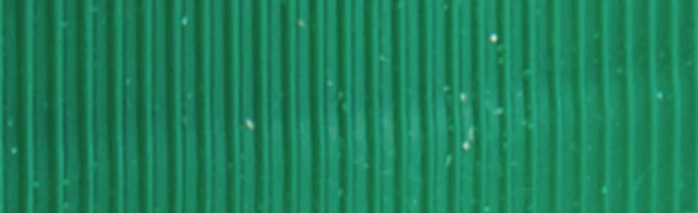

Hello everyone,
I'm looking for recommendations on Photoshop Plug-Ins, Neural Filters, or AI software that can automatically remove dust from product images. I don't need to clean sensor dust, just the dust on the products like the one shown in the attached image.
I was considering trying Retouch4me, but it seems their website is currently down, and their tool is more portrait/skin based than product-based. As I work on hundreds of images per week, this is a time-consuming task, and I'm hoping to find a more efficient solution.
I've experimented with various combinations of D&S filters, High Pass Filters, Median Stack Mode, Darken Blend Mode, and Find Edges filters. While I've come close to success, I haven't found anything that works perfectly.
Any suggestions would be greatly appreciated. Thank you!

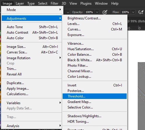

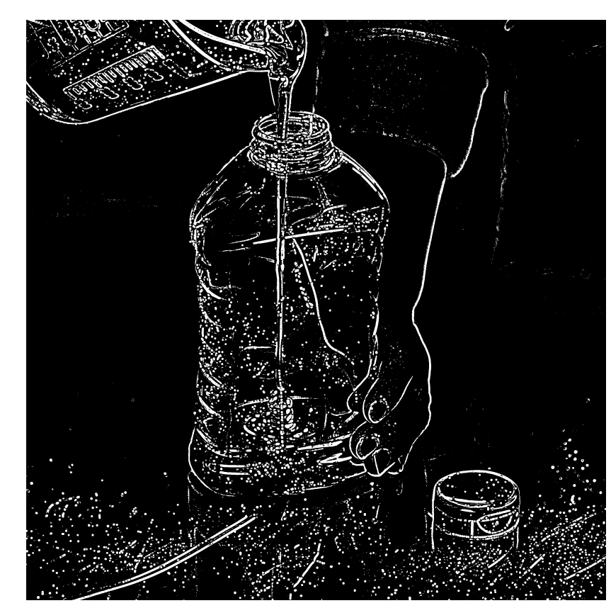

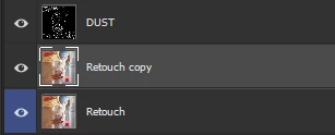

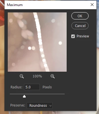

I have not tried this one yet! I will give it a shot. It looks promising. For now I have just been using a layer with median noise filter, and then adding back in the noise so it matches the original image. Then brushing it in.
In terms of selecting the dust/scratches, does anyone have a good reccomendation for this? I have done some testing with Color Range, Find Edges, and using a High Pass filter.
Method used below
Duplicate Layer
Rename Duplicate "DUST"
Run a Maximum filter
Run a high Pass
Apply a Threshhold Adjustmen
Copy Canvas
Select Original Layer
Duplicate Layer
Create a blank layer mask
Apply Clipboard to Dust Layer Mask
Select the layer and Run a median filter

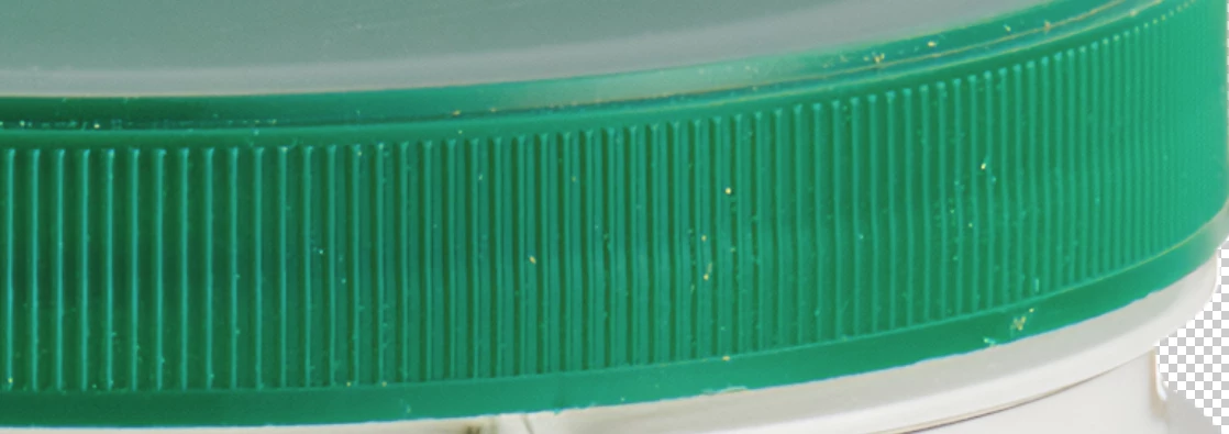

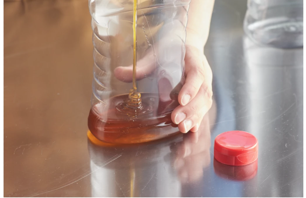

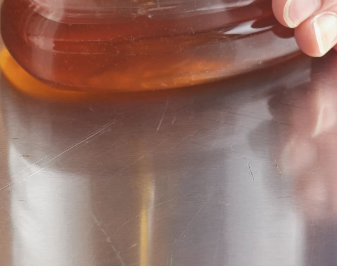

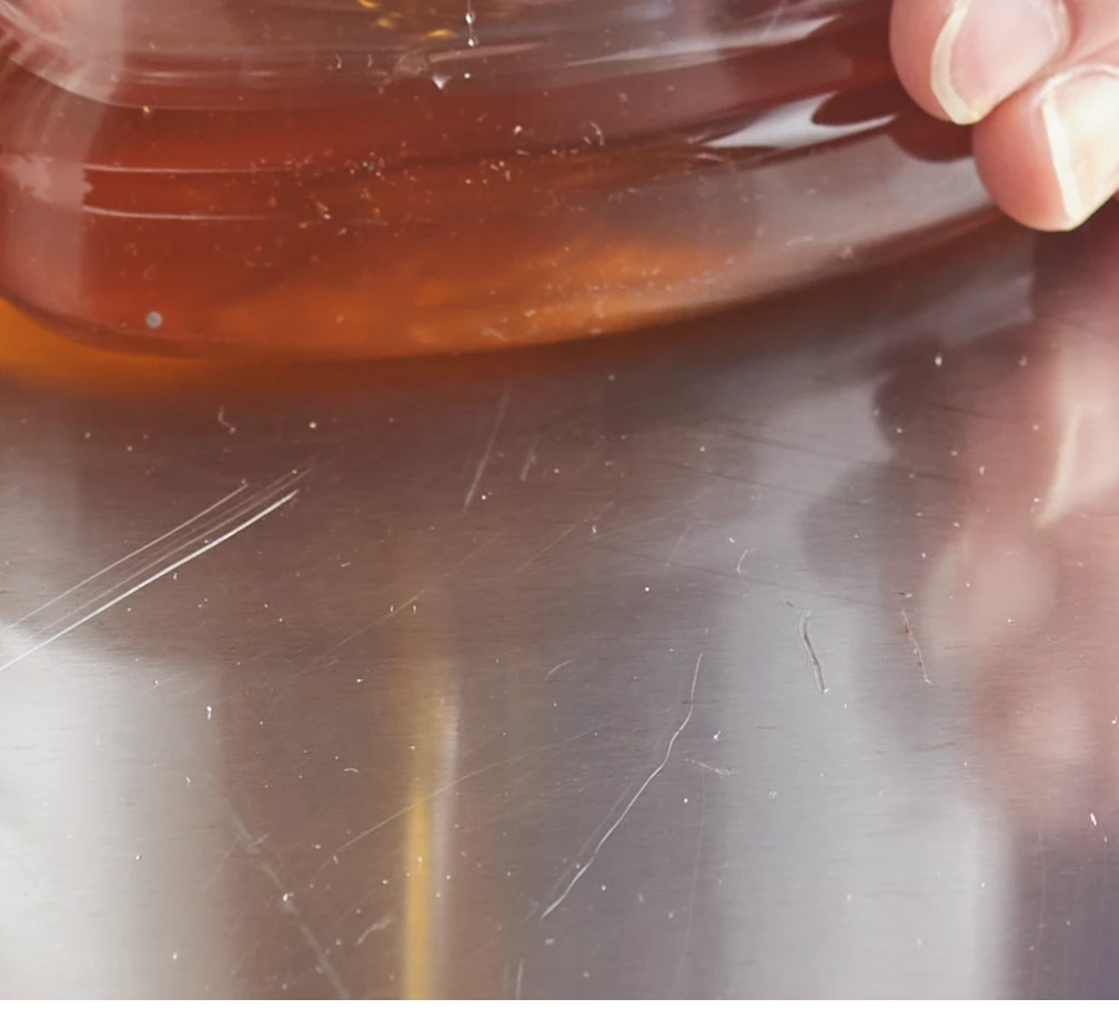

Here is a before and after or where I am at now.
January 18, 2024
Thank you so much for listing this out!  I recreated it and am testing it on a bunch of images.  I liked the Retouch4me dust filter, but it honestly took a little too long and this seems to have done the trick.  I really appreciate your taking the time to write it out with screenshots!  also had to look up how to copy> apply that directly to a layer mask, so def learned some stuff today.https://www.google.com/url?sa=t&rct=j&q=&esrc=s&source=web&cd=&cad=rja&uact=8&ved=2ahUKEwj78rDcueeDAxVamIkEHR8wAtkQwqsBegQIDRAG&url=https%3A%2F%2Fwww.youtube.com%2Fwatch%3Fv%3DVzvv0DfvJm8&usg=AOvVaw2jW2NDOn2VRhjfhcuUE8vc&opi=89978449

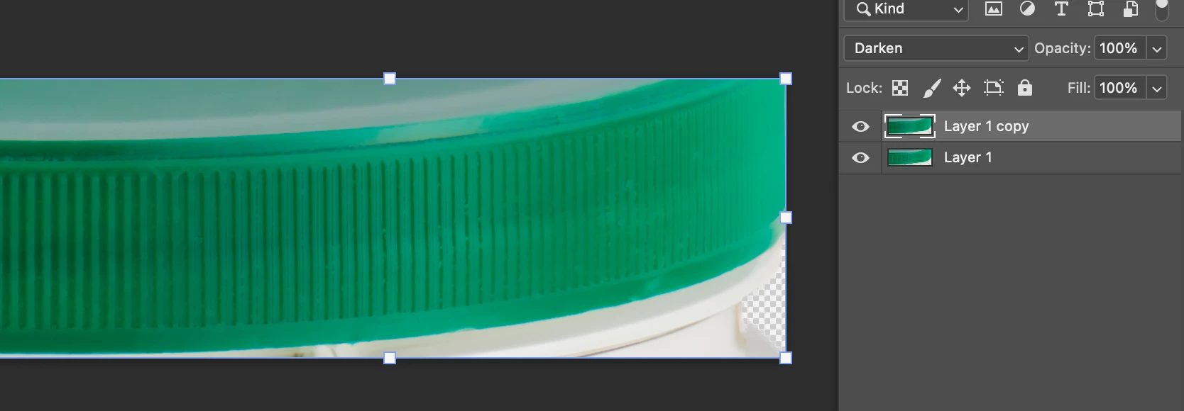

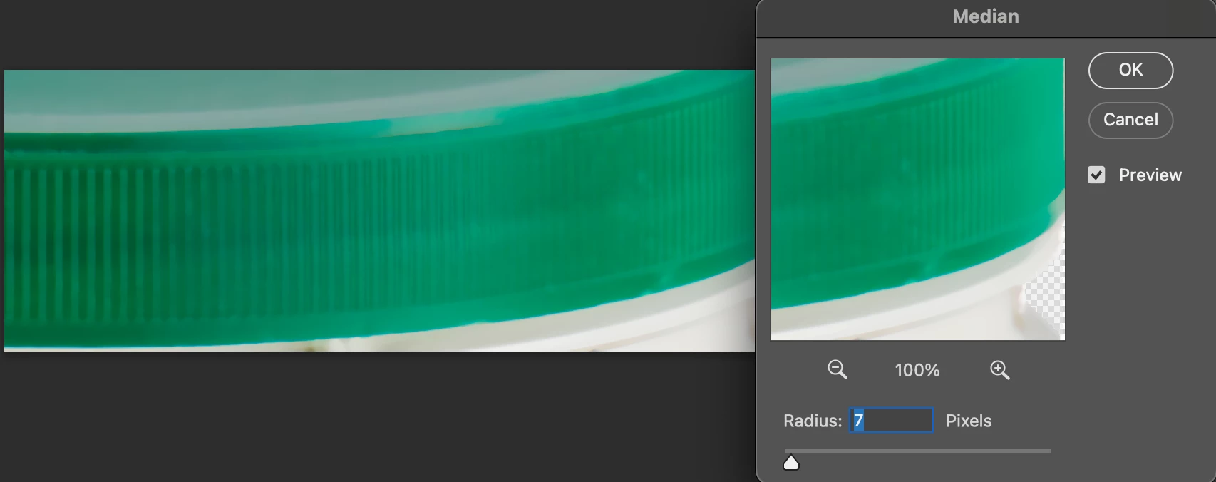

A bit of effort but it could be a recorded action - I took your image and replicated the layer.
I then ran the Median filter to get this:
and then set the layer to darken - any white specs get filled in with the overlying color.
