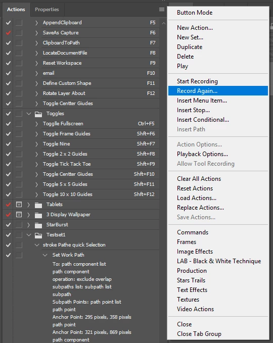

It is not a bug. Photoshop is working correctly. Double-clicking an action step is like using the action palette fly-out menu record Again.
You are re-recording the step. If the step function has opened, it will open with the recorded setting populated in the dialogue. If you want the CMD | Ctrl key recorder you must press and hold the key while making the changes you made to the step. The action step wants to be changed. So do not forget to highlight the action set and save the set so you will not loose the change should you get reset and you have to reload your action sets.
Its a way to edit the step
