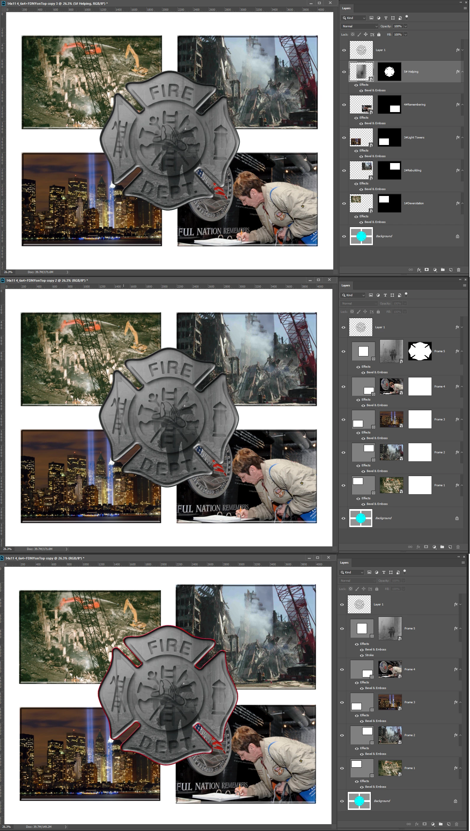

Why does Adobe treat their customers as beta testers and release incomplete features with all sorts of compatibility problems.  See how different Frame from Layers works when the layers have layer mask and vector late mask are present.   Layer styles work in these Frame layers.   The layer mask is shown in the frame layers in the layers palette however the Vector is not shown but is in there.  And the frame layers can be converted back to a normal layer with its normal layer mask and its vector layer mask.
Here is a Photoshop Photo Collage made using  Normal Photoshop image layers with layer mask and layer style etc.  I create a second identical one using Vector layer mask instead of normal layer mask. not shown here   I converted these two Collages in  Photoshop CC 2019 using frame from layers  Look how different the layer palette looks the content thumbnails Layer mask or lack of layer mask looks.  Is Adobe design compatible with Photoshop.  Smart filters work on these placed image but the Filter previews is messed up.  However,
All Collages Look same OK...

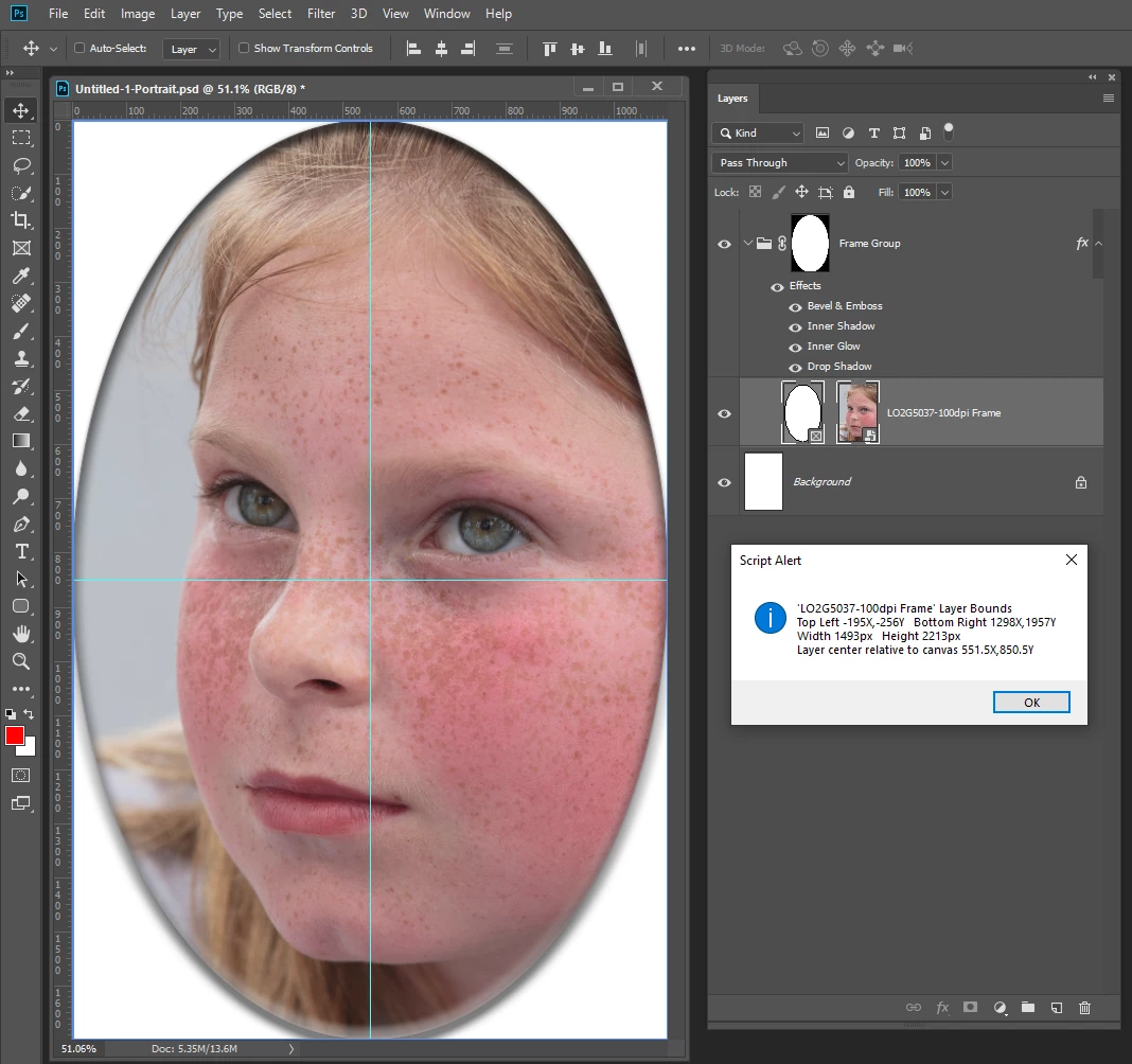

The new Frame feature has problems. Though Adobe clams a frame is like a Mask it is not like a layer mask that  defines the Layers bounds and pixels area shape.   So  a Frame layer is more a retarded layer that Photoshop does not know  what the layer bounds is or  the shape of the layers pixels area.  A frame layers bounds is the rectangular Size of the Placed  image layers associated transform not the frame.  However Photoshop clips the layer composite to be within the  frame opening shape.
It you want to add a layer style to it you can indirectly.  You can group the frame layer(s) into a layer group and add a real layer mask for the frame opening and add the layer style to this group.
Also when you use Photoshop  frame feature make sure you set the document  Resolution to the print resolution of any image you will frame before you  frame it.  Image Size resample NOT checked set print resolution. Frame uses Photoshop Place feature which only works correctly when the Document Resolution  is the same as the image places in the place operation.   Or after you place in  the image open the layer object and set its resolution to the document resolution is different and commit the change update the smart object layer.  Photoshop will the render the correct size smart object layer.   I'm waiting for a CC 2019 update before I do more testing.
Even when a frame layer is the current Photoshop target the is nothing in the Channels Palette or Path palette for the frame area. However you can Ctrl+Click on the frame in  the  layer in the layers palette to set selection for the open frame area.
Frames also seems the  have a scaling problem it will not scale up an image to fill a frame.

Thank you JJMack for a very insightfull reply.  And not the least for suggestnig the work-araound with the layers group which I tested and found working.  Your commetns regarding resolution has me a bit confused and concerend. With these shortcomings I doubt that I will be using the new tool much but rather revert back to using regular layer masks or shapes as clipping masks.  Hopefully Abobe picks this up.  Have you filed these issues as bugs or feature ideas?  I would like to but I'm having trouble finding out where inside the the Adobe homepage to do so.

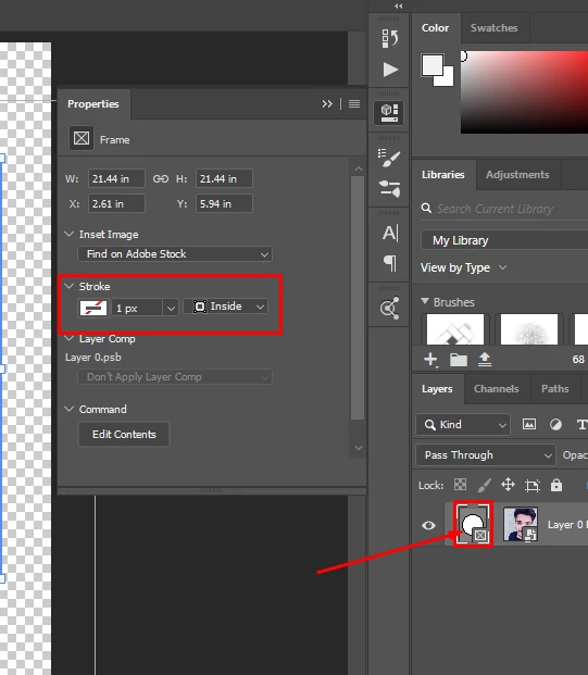

Hi, YES you are saying correct. It is a Feature that Frame doesn't allow any layer styles on itself. As you can you can place layer style on the content.
But You can apply Stroke on frame tool itself.
Click on the Frame thumbnail in the layer panel and open properties (Window > Properties) and you can turn on the stroke.
Thanks.
