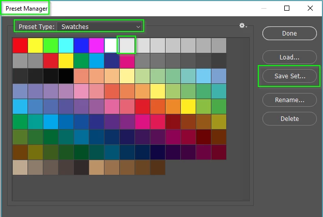

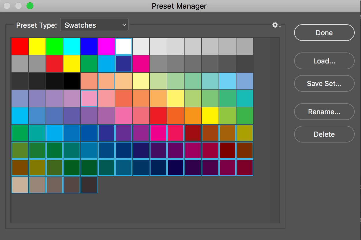

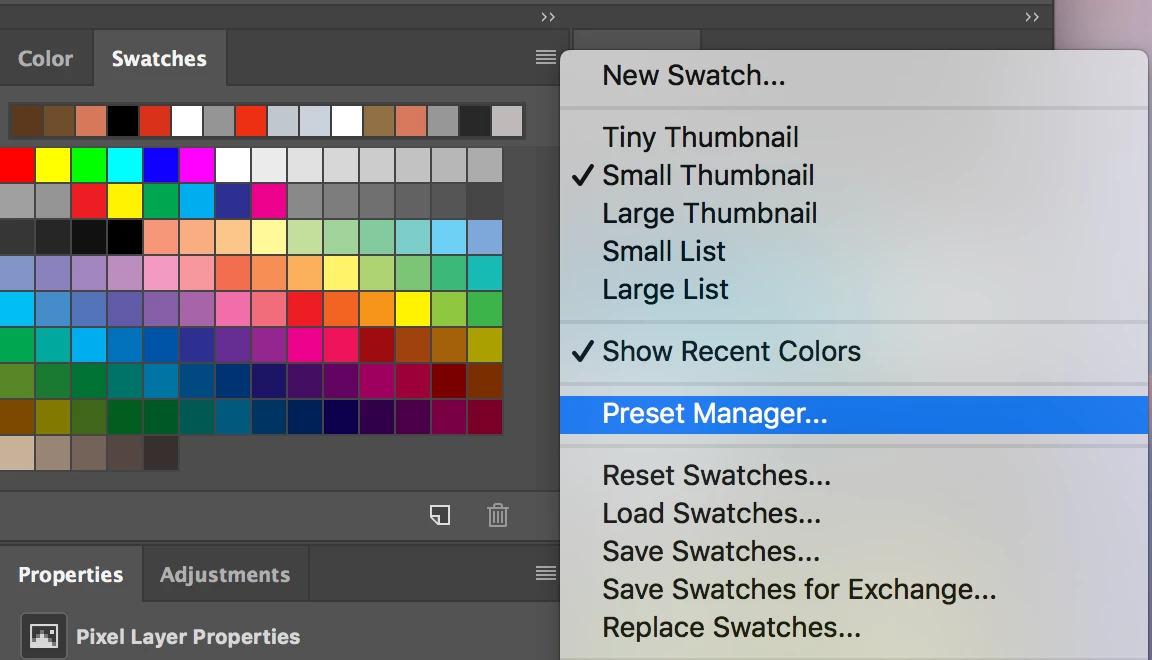

That shortcut isn't working for me, either. But you don't have to return to an earlier version of Photoshop. You can either right+click a swatch and choose Delete Swatch, or drag it to the Trash can in the lower right corner of the Swatches panel.
Alternatively since the original plan was to delete all the swatches, just use the Preset Mgr in the Swatches panel menu. You can select multiple swatches using Shift (consecutive) and Control (non-consecutive), then save the set.

Actually, this is helpful (though the solution isn't mentioned directly in this post). From this screen, you can use Cmd-A to select all of them, then click the "Delete" button on the right-hand side to clear all swatches. It's poor UX, but it works.

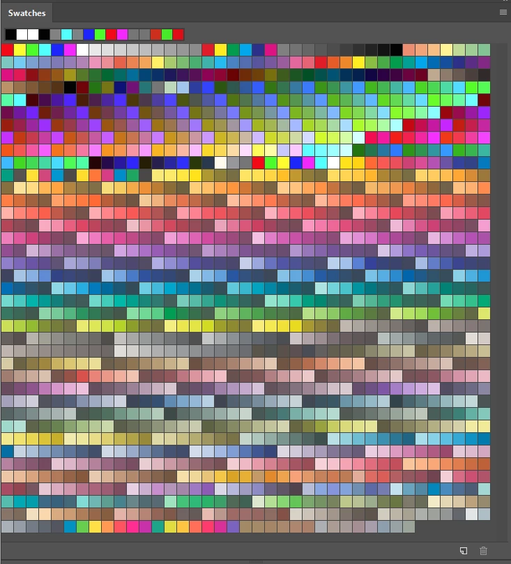

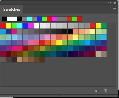

I'm wondering if we are misunderstanding you.  There's no reason to delete swatches as such, but you might want to remove them from the Swatch panel.  Thatr's easy to do.  If you have appended additional swatches, and end up with something like this:

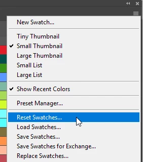

Just reset the swatches
And chose OK rather than Append, and you are back to the default.

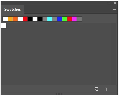

My goal was to start with a blank swatch manager. My options were:
  • drag each individual swatch to the bin in the bottom right (repetitive operation)
  • Right click, delete, confirm (for about 50 swatches, that takes a while)
Resetting to default would just fill up the swatch manager back up with swatches I don't want. But thanks for your help!

You need one swatch to create a new set, so open the Preset Manager > Swatches,  select a colour (it doesn't matter what it is) and Save the set with your new custom name.
