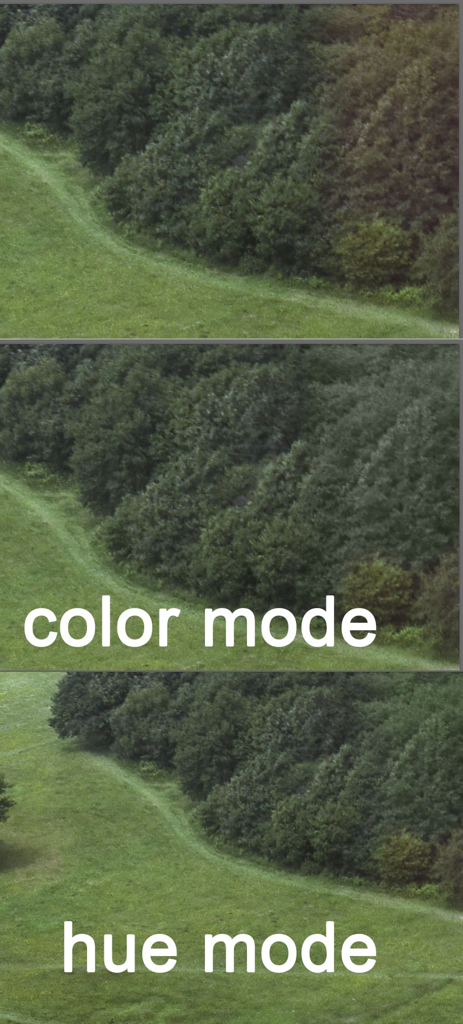

using the method again on the trees, colour mode best, but  I cannot get them to the same punchy appearance as those immediate left of them, , trying levels contrast hue sat light, on the layer with the painted brush on it, nothing seems to happen much. Whats the trick there ?

@Merlin3– Without seeing the image, I'd try adding a new blank layer set to colour or hue blend mode, sampling the desired colour with the eyedropper, and then painting in the new layer with a brush. There are different variations on this general approach, such as adding a solid fill layer with a black layer mask and painting in white on the mask.

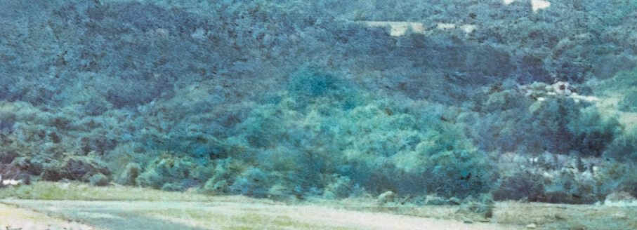

three examples attached first one distant shot of trees, having to try and fix a reflection from within the helicopter the trees are a different hue, I wish to select the wrong hue part and then say to Pshop match the hue of that at left and/or that at right., by selecting an area with lasso tool or paint in quickmask mode. or pipette set to a large sample. I would prefer drawing an area to supply the most area to sample from.

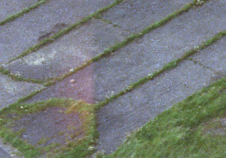

In the second closer to view of ground there is some minor light bleed across the 35mm film, gone a bit orange, so select the grass and trees and say match the hue of area to left.

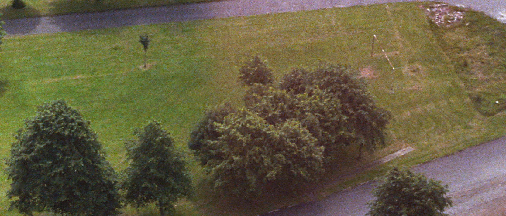

Third example light bleed this time across tarmac, need to sample the adjacent tarmac and say match the hue in that area, likeweise the grass there. to match the strip of grass. perhaps the grass and tarmac in one 'hit' would do it, being all of one correct unafflicted area ?

One possible method:
  1. Add a new layer, change it's blend mode to Color or Hue mode
  2. Select the Brush tool
  3. Depress the Alt/Opt modifier key to temporarily change to the Eydropper tool
  4. Sample the wanted/good colour
  5. Release the modifier key and paint in the new layer
  6. You can sample and paint other colours to add variation, using brush opacity, blend modes, or Gaussian Blur the layer etc.
Note: instead of using the brush tool, you could use the Clone Stamp tool to paint with variation. Or use the mixer brush etc.
P.S. You may find that you also need to account for tonal issues, which color or hue mode doesn't address.
There are many different methods and what works for one image may not work for another. In other cases, you may need adjustment layers such as Hue/Saturation and use a gradient in the layer mask or hand paint the layer mask.
