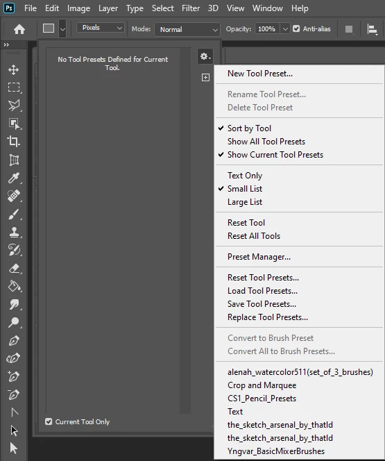

Have you reset the Tool yet?

How can I do that?

One way is to Right Click on the tool Preset pull down icon in the tools option bar and then click Reset Tool or Reset All Tools.
or use the pull-down then use its  settings
