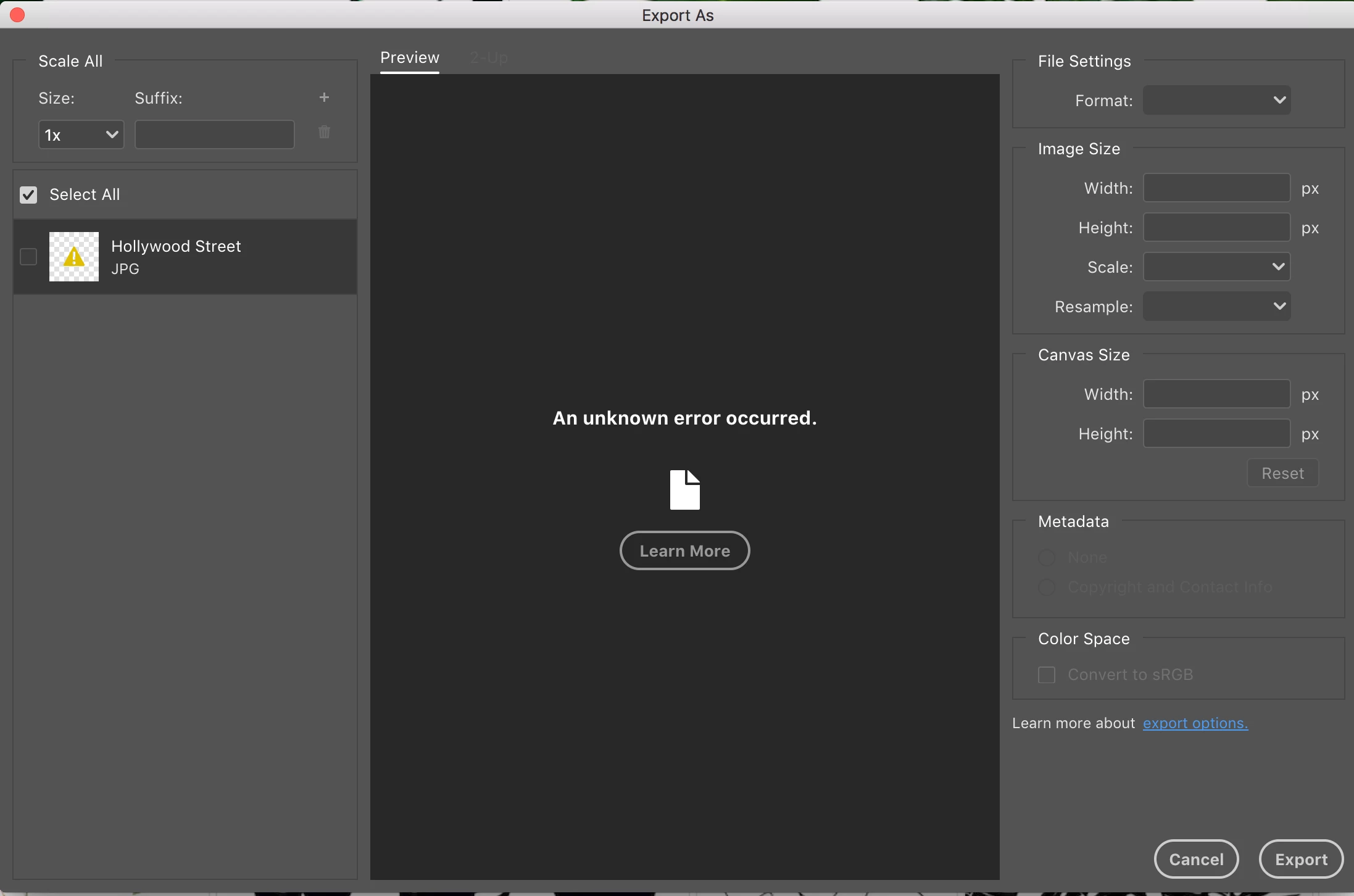

"An unknown error occurred" on photoshop 2020 when exporting
  • June 11, 2020
  • 4592 views
I have seen a few posts about this "an unknown error occurred" with no solution that I can find so far. I am on photoshop 2020 on iMac High Sierra.
I have already exported a handful of images as jpgs, but even pulling up the export menu on one or two project prompts this error message to show up and the photo of the project doesn't even load. I spent 75 hours on this project and then this happens. I don't feel confident in photoshop to work on one single project and have this occur.
Does Adobe or anyone have the solution? Most art projects worked out fine except for the scaling down issue which I will have to ask about in another post.

January 11, 2021
I had the same problem after updating to Big Sur and I solved it by re-installing an older Photoshop version (22.0.0)! Works as an intermediate solution while they have not fixed it.

June 14, 2020
Hi Spencer,
We are sorry about the experience due to the error while trying to use Export As.
Please update Photoshop to the latest version(21.1.3) through the Creative Cloud desktop app and check if the issue persists. You can also try to reset the preferences of Photoshop using the steps mentioned here: https://helpx.adobe.com/photoshop/using/preferences.html
Please backup your preferences prior to resetting them. You can check: https://helpx.adobe.com/photoshop/using/preset-migration.html
Also, please note that we've noticed this issue occuring with some specific GPU drivers, please checkout this discussion for more details: https://feedback.photoshop.com/photoshop_family/topics/export-to-error-in-ps-cc20-0-1

January 2, 2021
Yeah, that doesn't really work, I have the 23.1.0 version with Big Sur and the problem is only becoming more and more persistent. Unfortunately.
