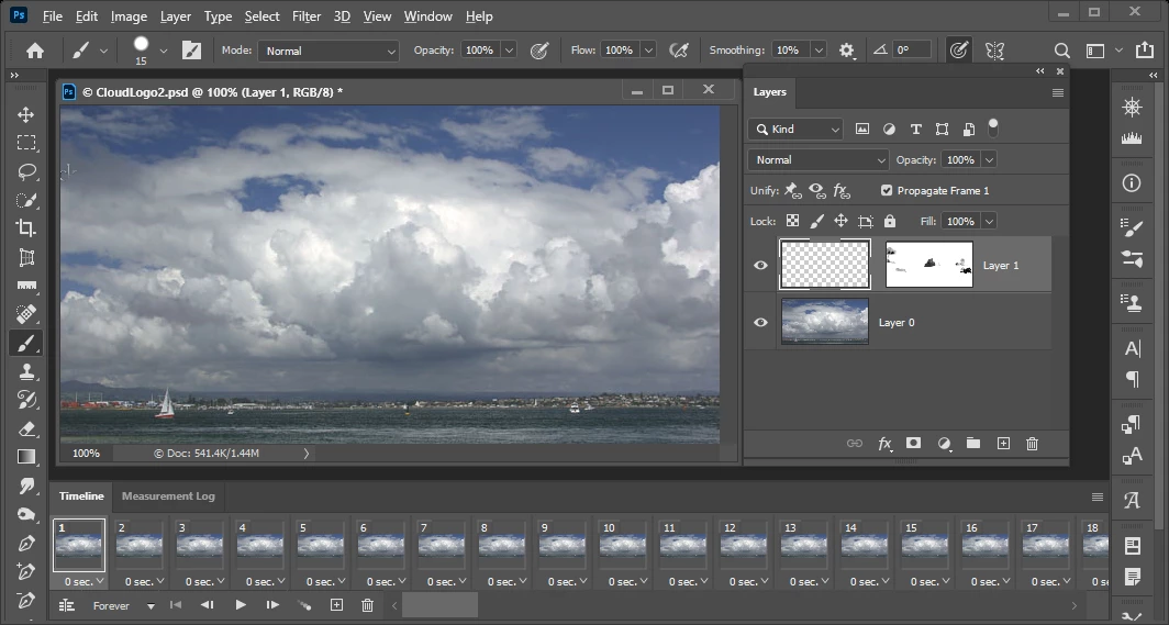

Tween would animate the position change of the layers visible in first fram to their changed position in ths second frame.  You did not have layer positioning change.
Here I have two layer  I created two frames with these layer visible. In the first frrans I position the top layer content hight and to the left. In the Last Frams I positioned its content low and to the right.  I had tween genrtate the framst between the first and last frames.

I described how tween works If you want to change character pose tween is not going be able to do that,  There may be an onion skinning feature in photoshop somewhere in frame or video animation,  Smart object layers can be transformed in video animation and in 3D layers you can rotate objects in 3d space.  In crafting a frame animation I would the tools like puppet warp would be  helpful for making layers for new frames.
