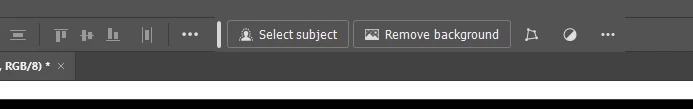

Photoshop Latest version has too many issues like,
  1. Annoying floating toolbar, this is decreasing the working speed and creating disturbance while work.

traviss66493560
March 27, 2024
Floating bar is annoying because it blinks in and out of existence. It is distracting.
I wish there was an option to dock it, like on the top bar or the side.
Docked here would be nice.

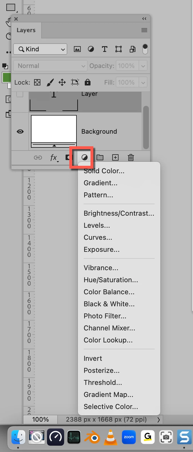

jane-e
May 25, 2023
@D Fosse wrote:
So now I've set up keyboard shortcuts for the adjustment layers I use the most.
A second option if you forget a shortcut and for the less important ones is to click the button at the bottom of the Layers panel:

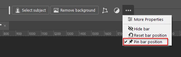

1. Turn it off using Window > Contextual Task Bar
2. What is 'not good enough' . You will need to show some examples, I would suggest in a separate thread, where it has issues. There is never though going to be a single press feature that works on every image.
3. White blocks when masking - sounds like a GPU issue. Try Preferences > Technology Previews and Deactivate Native Canvas, press OK and close and restart Photoshop. If that makes a difference, then update your GPU driver and then reactivate.

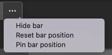

jane-e
May 25, 2023
@Shalendra29402647jjfv
In addition to turning off the Contextual Task Bar, you can also put it where you want it, then pin it using the ellipses menu on the far right.
