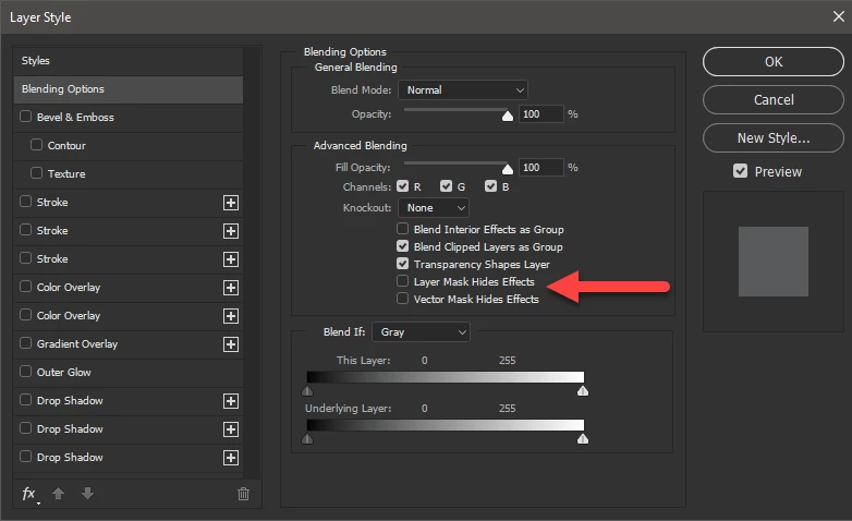

I probably can supply an answer to question 9. It's not a bug but is due to the order in which Photoshop executes layer effects. By default a mask is applied first and then a shadow, therefore the shadow is not masked. You can easily override that behaviour by putting a checkmark in 'Layer Mask Hides Effects' for a pixel mask and 'Vector Mask Hides Effects' for vector masks.
