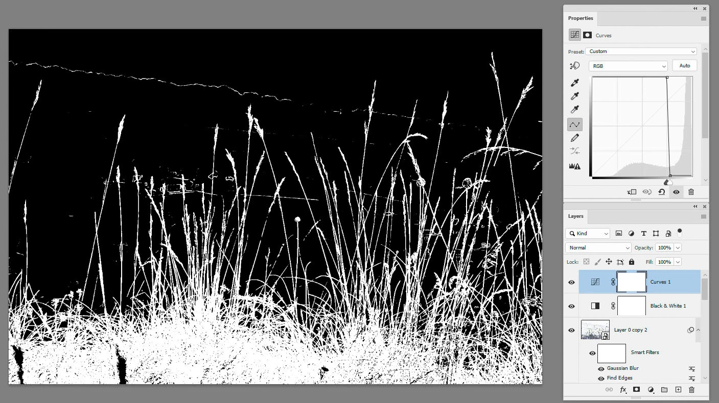

So next I tried bit of lateral thinking. Taking a copy of the image and using Find edges followed by Gaussian blur then using a black and white layer adjustment plus a curve to invert gave a starting point for a mask. The top edge of the land needs to be brushed over as do some lines around the farm and some holes at the bottom.

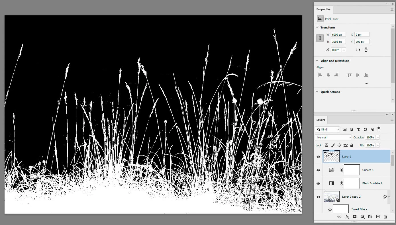

A couple of minutes with the brush to brush out the obvious areas gave this:

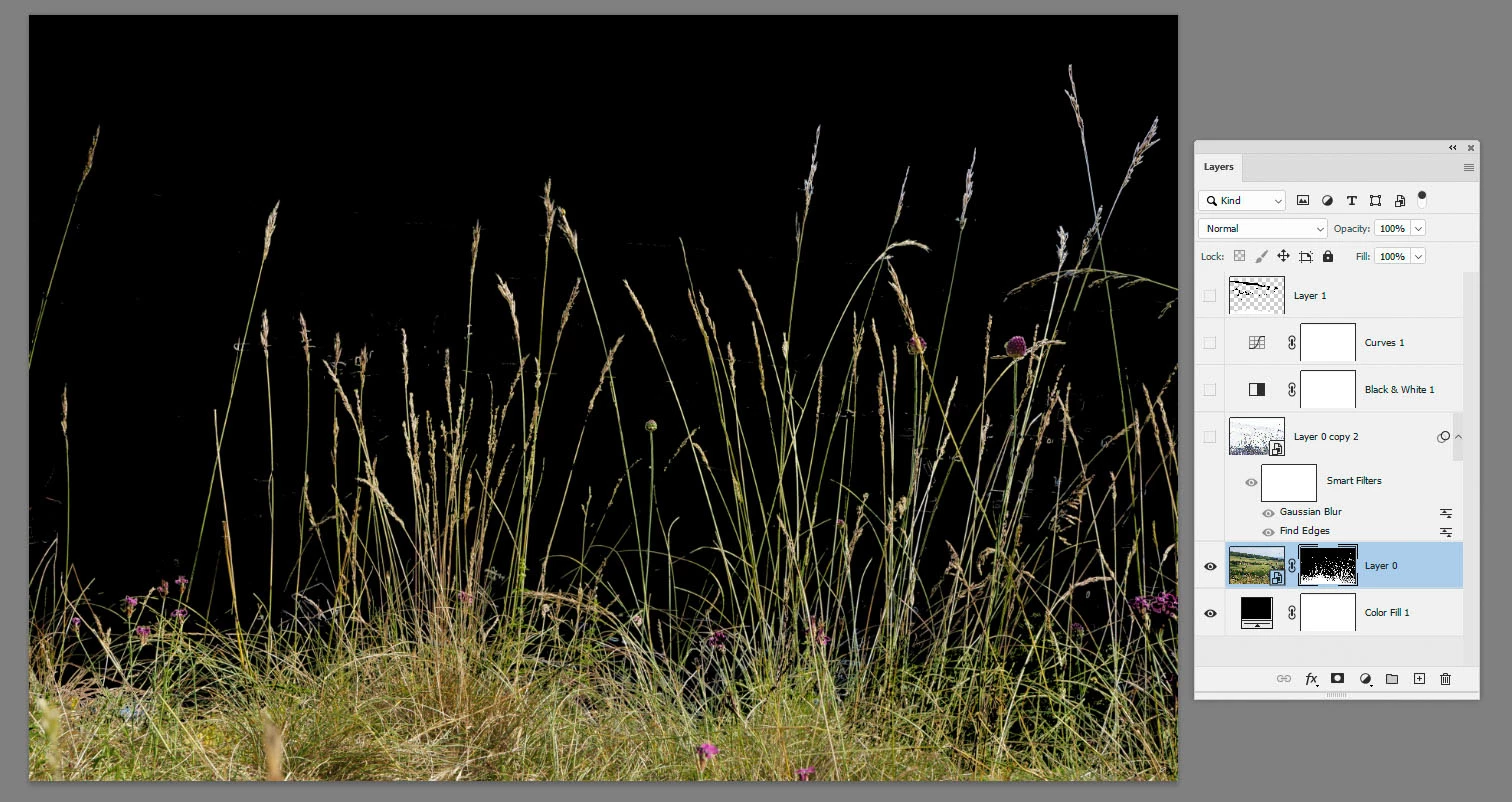

Then making the result a mask :
How much work it still needs to finish it depends on what you are using it against. I would not finish it until I had it in the new composite.
