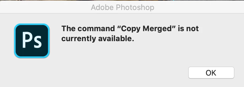

I am trying to copy the active document to a new document with the layers merged
photoshop cc 2020 javascript
here is what I have tried:
var docRef = app.activeDocument;
docRef.selection.copy(true);
the photoshop message I get is:
I am undoubtedly missing something.

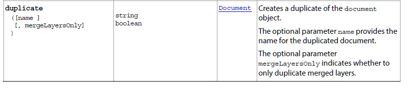

April 28, 2020
app.activeDocument.duplicate(duplicateDocumentName,true);
May do the duplicate merged

April 28, 2020
That looks like it would be a copy merge of all layer active selection to the clipboard. Did the script set a selection first? You should post the full script...
