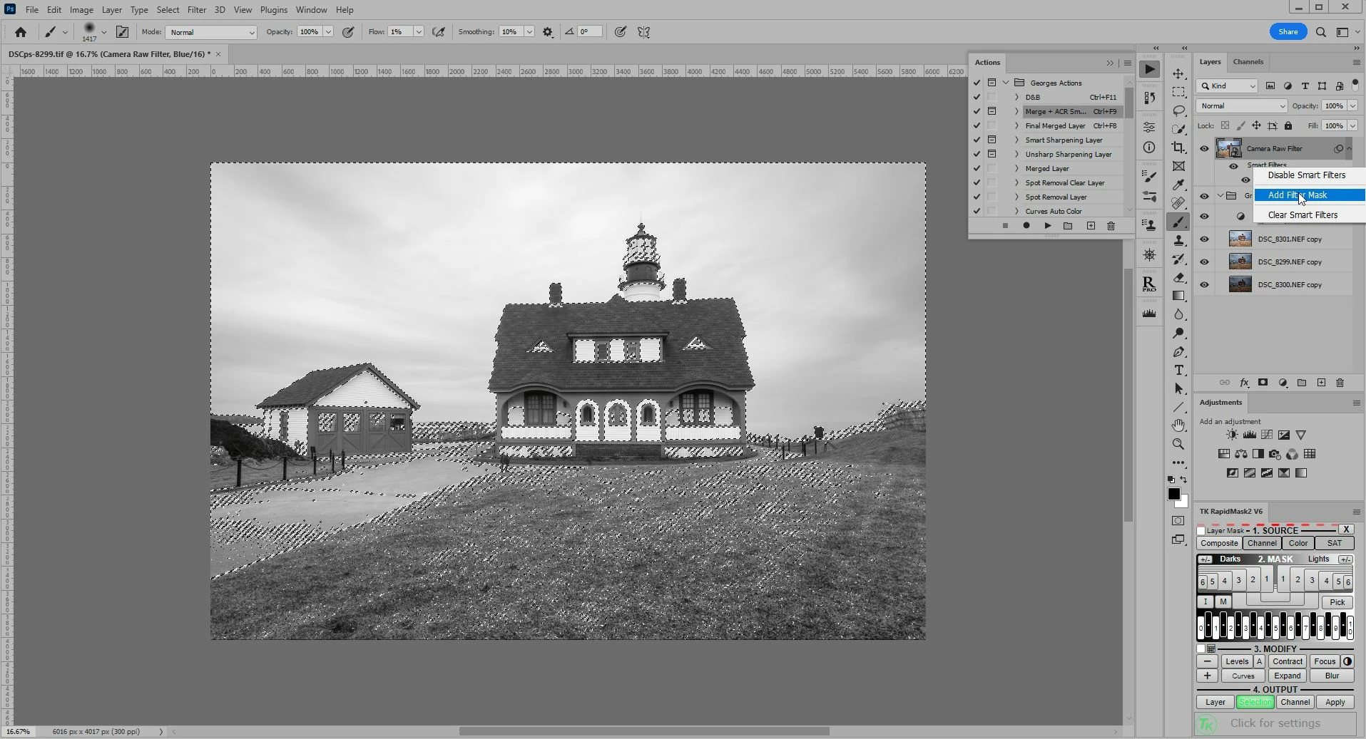

Having an active selection and adding a mask via Right Click > Add Filter Mask worked for me.
Having an active selection from the Channels Panel and applying it to an existing smart filter mask also worked for me.  Have I perhaps missed a step?

If you desire to do so, its possible to delete a smart filter mask and make a new one by right clicking on the area under the layer that says "Smart Filters" and there is an option there to make a new mask on the smart filter.  I also confirmed it would make a mask from a luminosity selection.
