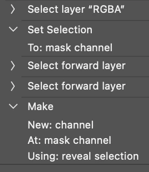

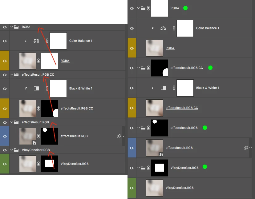

Hi everyone! I'm developing another automation for my work. Everything was correct, but I forgot a variable. Is there any script that can apply the mask that is on the Layer to the group it is in? The layer names will always be the same, as well as their groups.
Thanks for the help!
Correct answer Stephen Marsh
I'll post the code later then!

Stephen's Code worked perfectly. Really if the groups had different names it would be much easier, but it's something I can't change.
Thanks Stephen and everyone for the help!

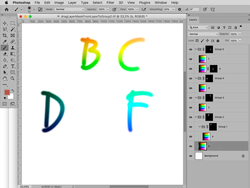

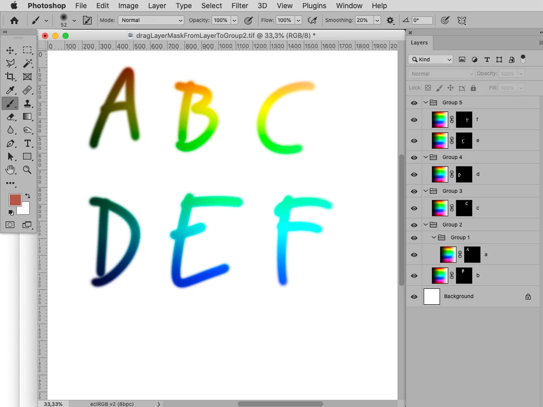

The code below would drag a Layer’s Layer Mask to its Group unless it already has a Layer Mask.
code edited 2022-05-03

@c.pfaffenbichler - That's a useful bit of code, skipping over existing layer masks, thank you for sharing.
P.S. I just had time to set up a test and I really like how you loop over the layers/sets and compare the names, rather than hard coding in a fixed set of names!
