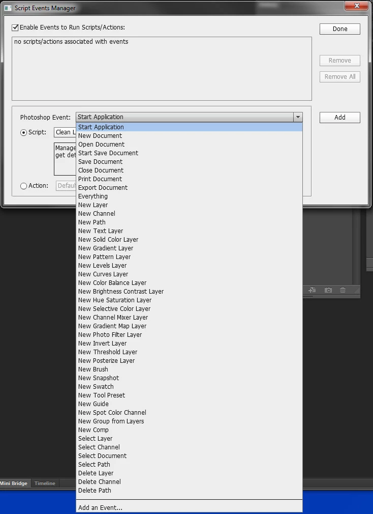

Hey guy, I'm just getting into CS Extention Builder, so still a bit of a n00b with this, and havn't been able to find anything about what I'm needing in the docs, forums or googling around.
How can I setup an event that gets fired when the user changes their active layer?

August 28, 2012
The simple answer is this. I have a bunch of interesting events commented out in the Script Events Manager.jsx file.
//  Class IDs related to event select
          inObject['events'].push( new EventData( 'Select Layer', 'slct', 'Lyr ' ) );
But this does not solve all of them. If you open/select/close a document for example you will get a new layer selected. If you make a layer, that menu item is commented out as well, you will have a new layer selected.
If a user runs an action or a script the current layer might be switched. There are a lot of edge cases unfortunately.

August 28, 2012
Un commenting most of the event Tom has commented ouu in the Script Events Manager script woul give you a much latger predefined list of events.

August 28, 2012
In Photoshop Scripting guide there is some code you can use the find out the codes the scriptlistner uses for events and in the Photoshop Java Scripting guide there is a list of IDs in Appendex A,  The Script event manager has some predefined events you can set event handlers for and you can add event to its list.  There may not be a ID for change active layer itself you may need to use some other event like select  and see if its select layer.  I do not know for I have never tried to add an event that was not allready in the Script Event managers list.  You need to read the two scripting guides on the subject of events, script event manager and the scriptlistener.  I beleive the information you need is in there,
JJMack
August 28, 2012
yes, that was not in the list of events,  thats what brought me here
