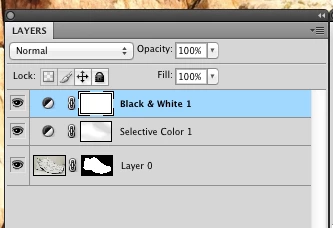

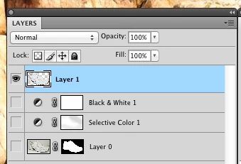

2. I need to create a script that identifies if the top most layer is a standard layer or adjustment layer. If it is a standard layer move on, if it is an adjustment layer then:
  1. Select topmost layer
  2. "Stamp Visible"
  3. turn off all other layers
  4. save(without dialog) and end.
To clarify here is an example.
This is how the final files should look.
This is how they sometimes look when someone hasn't correctly completed the file.
