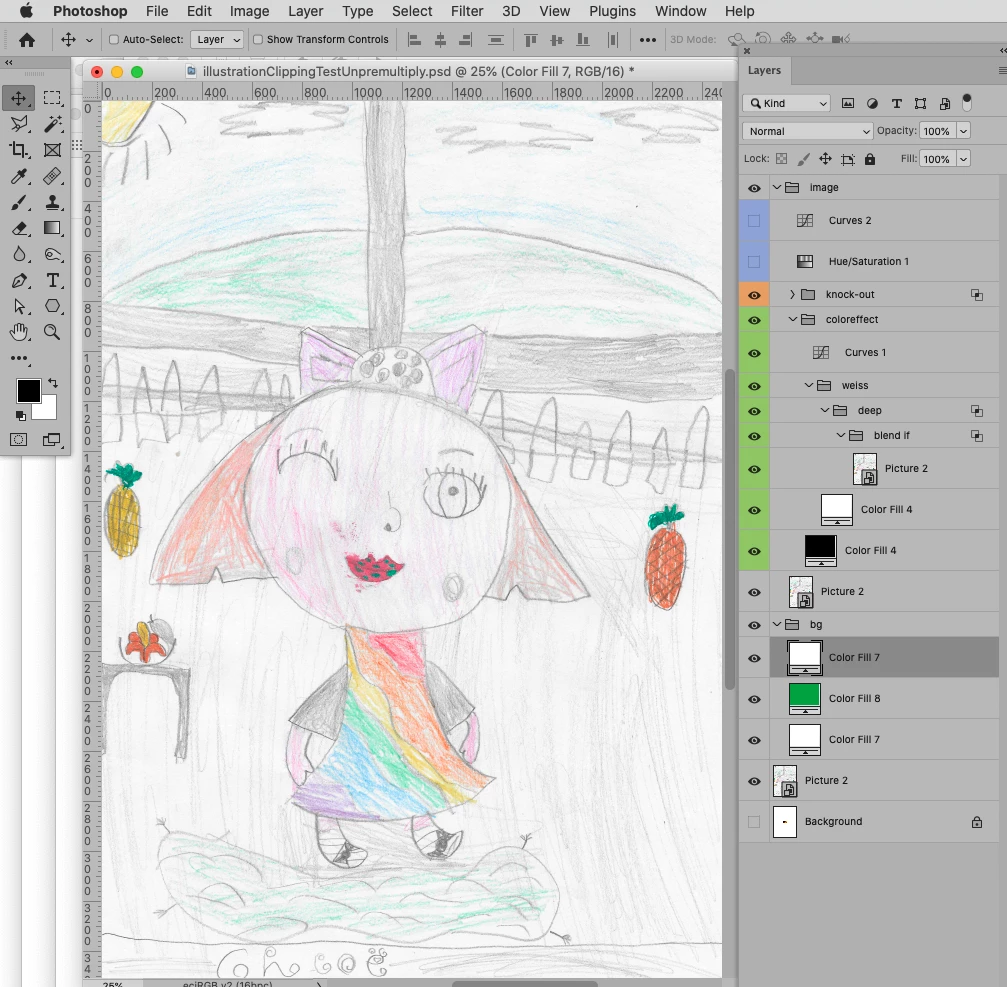

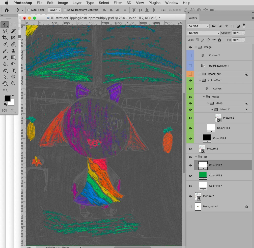

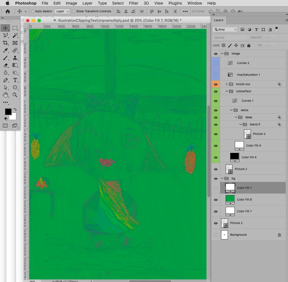

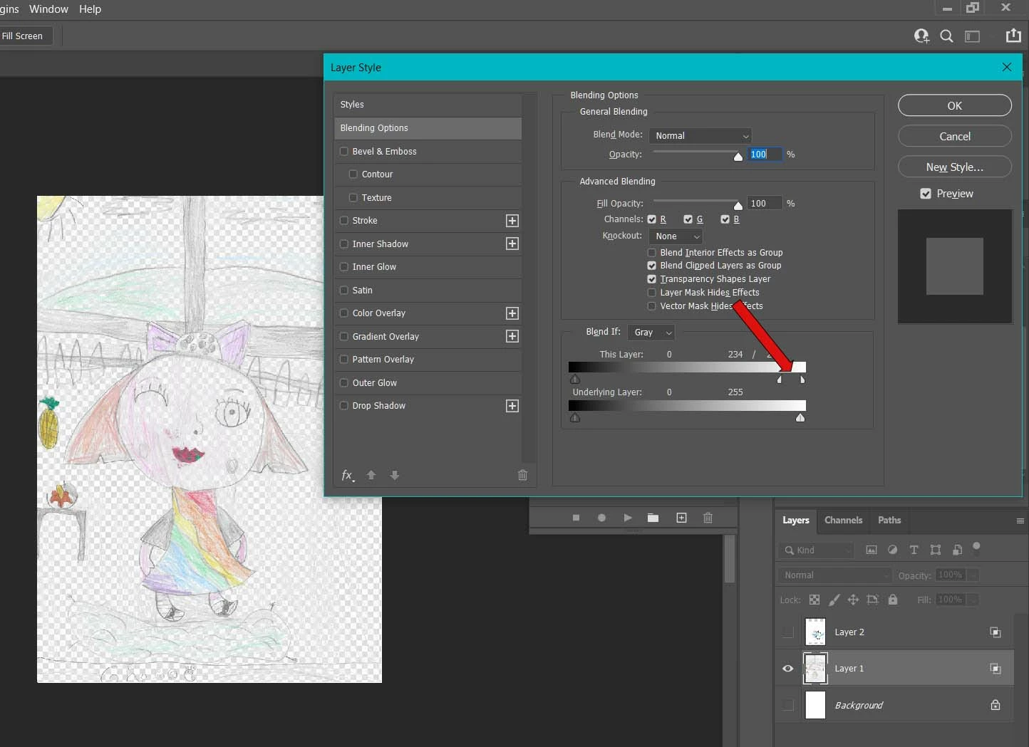

You can try using Remove Background from Properties panel. Mz advice is to try using Advanced Blending options, press Alt and click+drag left part inward as shown on screenshot below. You may need and some tutorial to understand how things work.
c.pfaffenbichler
April 26, 2022
Ond can emulate »unpremultiplying« with a fairly convoluted Blending combination.

Thank you,appreciate your time. I am trying to replicate what you have done, and can only follow to the Blend if.  I will try some more. I can see I will need to learn more about these features. Thanks
