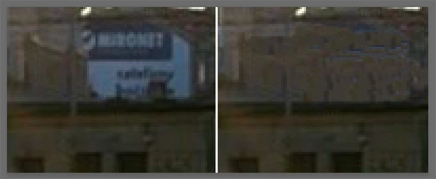

An enlargement of the area of concern is both lighter and blue (with, according to Lab Color, a hint of green).
Using the Clone tool set to Color will not do the job. It should be set to Normal in the Options bar.
This is a quick Clone, adequate in the size posted.
This is a soft image with significant areas of flat tone that provide an assisting texture. (Possibly from an iPhone).
The mood is apparent as is.  Authenticity is unimportant. Beyond the correction shown, why not leave it alone.
