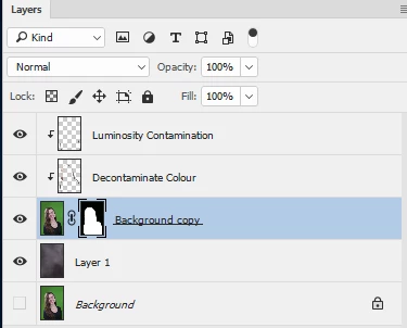

    With such a nice clean background Select and Mask does a fine job in very little time.
    In select and mask use quick select to do the bulk of the selection. Then go round with a small brush (I used 10px 100% hardness and 1% spacing) to paint on the edges of the hair - note this is only the edges and pick up the fine hair.
    Output to new layer with mask and do not  check decontaminate colours.
    Add a new layer clipped to the masked layer and with blending mode set to colour. Paint round the edge using the same colour as the hair. This will take out the green.
    Finally their was a bit of a light edge to the girl's top so I set another layer, clipped to the layer below) set to luminosity and painted the edges of her top with the top colour.
    Finally insert your background as a layer.
    I also increased the exposure ( the histogram showed it was under) and I warmed it slightly (but that is just me )

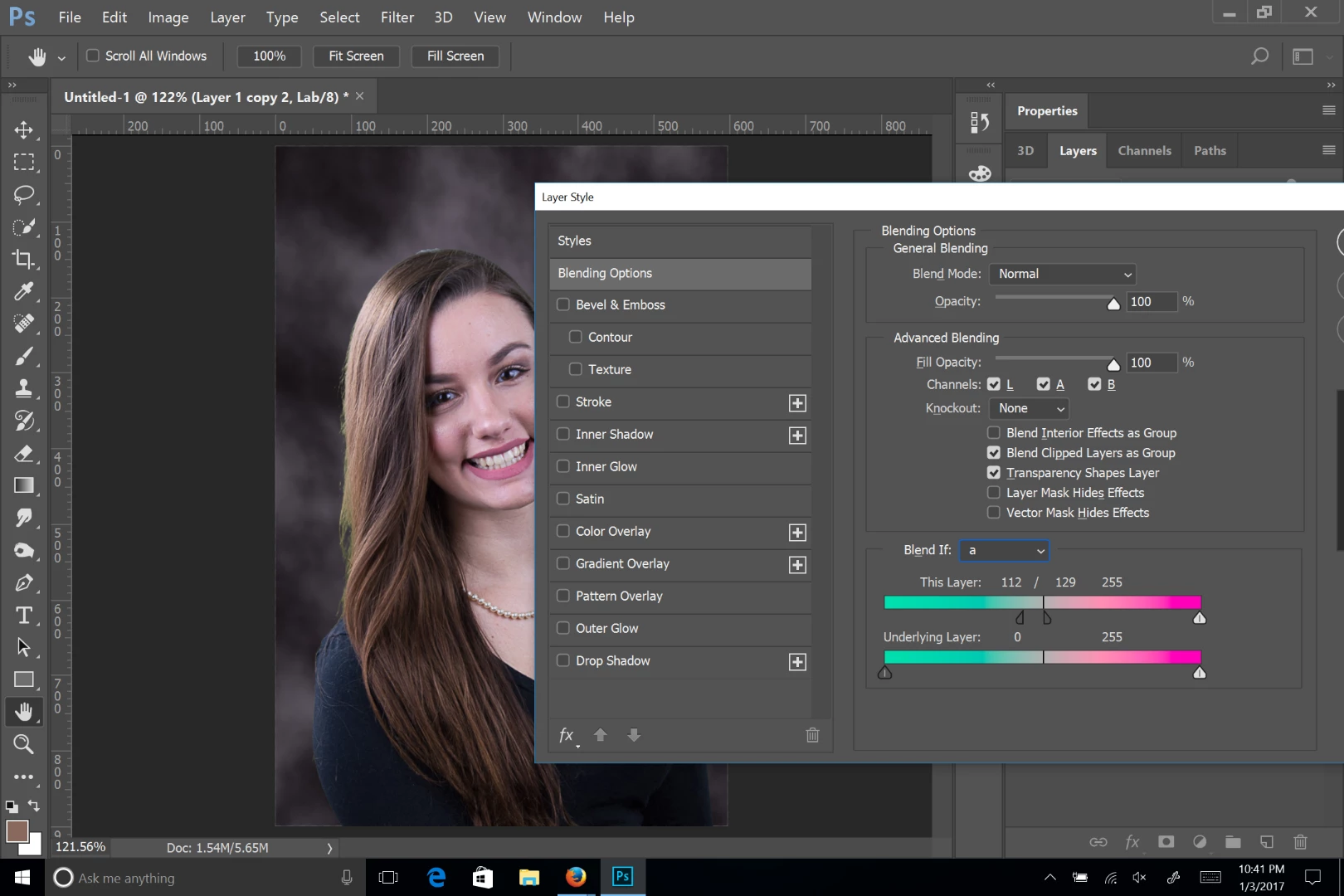

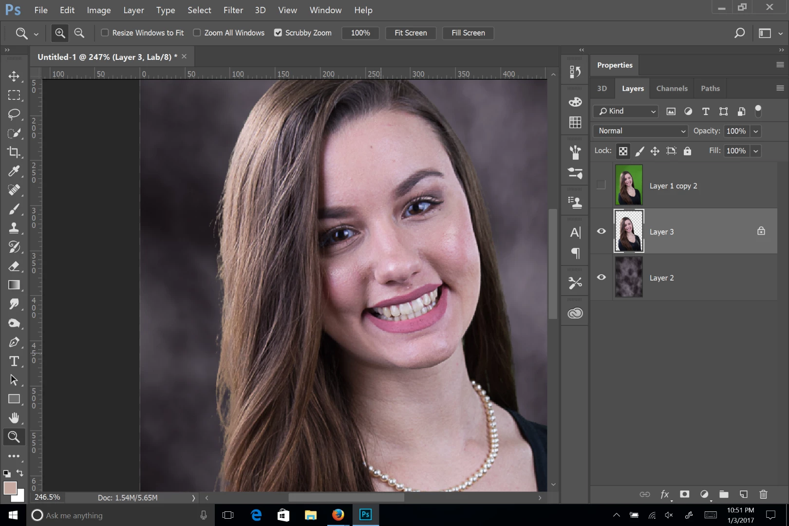

    My approach is different, as I don't care for the quick selection tools. Duplicate the original layer so you have a layer to work on without damaging the original. Change the image mode to L*A*B* then use the blend if slider to eliminate as much as the green as possible.
    Then add a blank layer and merge that with the layer with the blend if correction. This will give you a layer with most the green cutout with transparency. Now lock the transparency. You can then use the clone stamp tool or paint brush tool set to color blend mode to paint over the green fringe areas.
    Terri Stevens
    January 4, 2017
    That's such a nice method Chuck. It's interesting to contrast with Dave's method which seems to bring out finer hair detail, but I'd hate to say which is best as there are strengths in both techniques. With LAB you can really boost the colors far more than in RGB like below.

    I guess a lot determineso what you're comfortable using. I haven't had a lot of success using the select tools, and find it spend more time trying them than just making other methods like channels. My example was quick and dirty, I wasn't trying to do the best job, just show the steps.

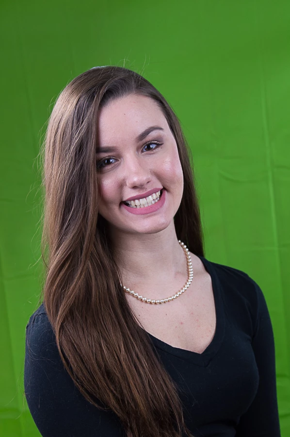

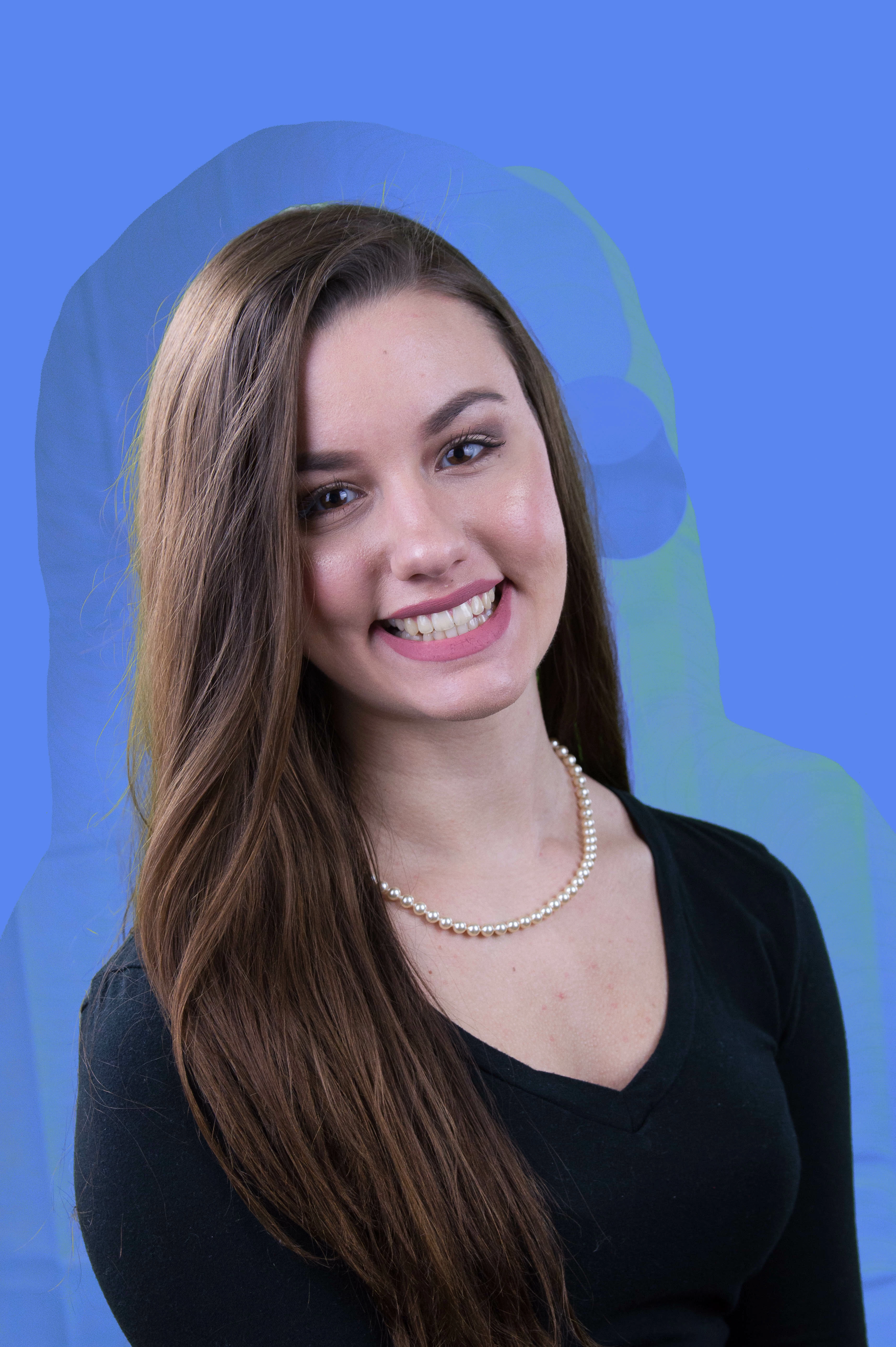

    Thank you everyone for the replies.   While I have experience in photoshop, I don't even pretend to have scratched the surface of knowing all of its intricacies.   With that, as a photographer and frequent user of lightroom, I certainly know better than to destroy an image but all the content I found online about digital backgrounds, the background eraser tool specifically, was used more often than not.   With that, I have attached 3 images.  The original shot, the background and the edited photo against a blue backdrop which clearly shows the brush strokes.   I fussed with the tolerance, I was using a hardness of 100 on the brush settings and even tried a mask but I am afraid my lack of experience in photoshop has left the ugly green bleed in the edited photo.     Again, I will never use the green screen again.  This is a friend but I do not want to have to call her back to re-shoot.    I have successful outdoor photos but shame on me, was trying something new for the yearbook shot and a digital background and did not use a plan b just in case.   These are cut down resolutions.

    Oh, and I have not done any touch up work on this.   This is all raw at this point.  My main concern being that I cannot get a clean clip.
