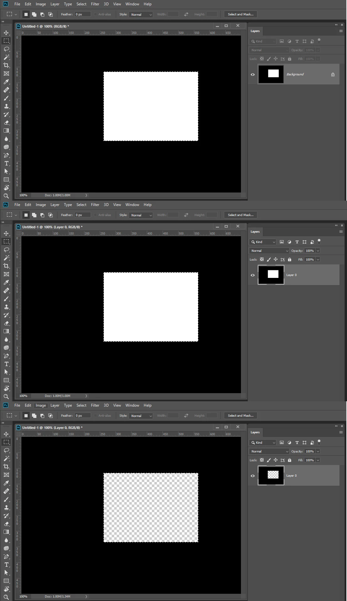

Also
Photoshop Background layer does not support transparency. Try converting it to a normal layer like Layer 0

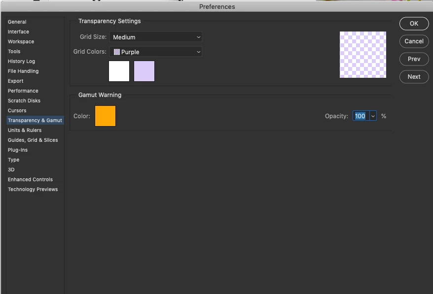

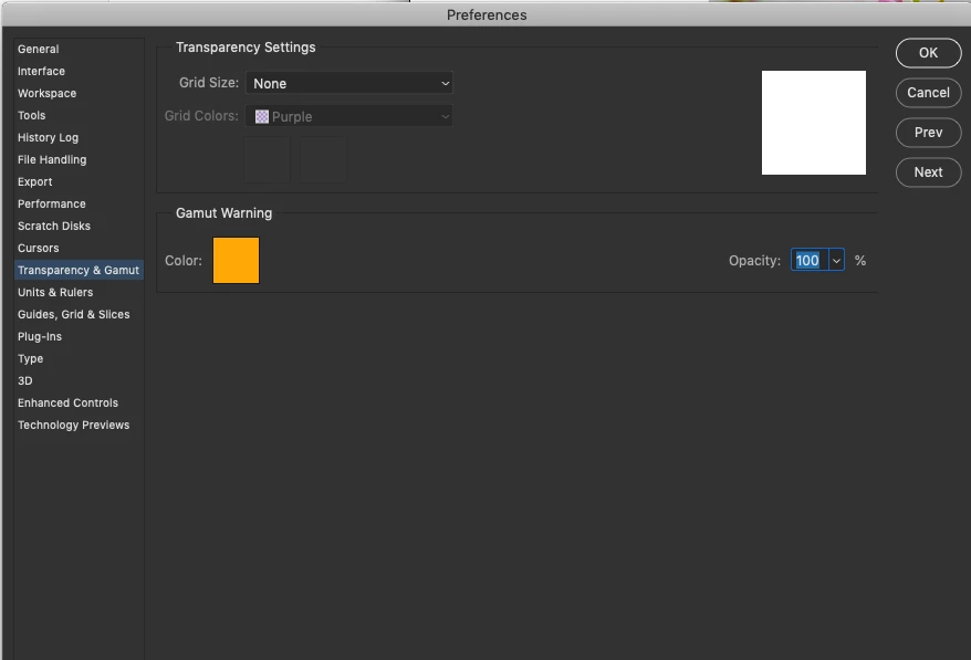

check your preferences. You may have it set to none on the background instead of the grid. In the image, it's set to medium, but if your's is none, it will just be white.
Set to Medium, you see the grid off to the right that will be behind your image...
Set to none, you see the plain white off to the right that will be behind your image.
