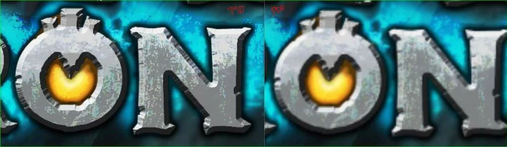

When I export a PDF the quality is so much poorer than my original PSD. I am using the High Quality Print preset.
On the left is the PSD and on the right is the PDF. I believe as the Destination setting I used something called "US - Web" which I suspect might be the issue but I am not sure what to choose out of the enormous list of 'destinations'.

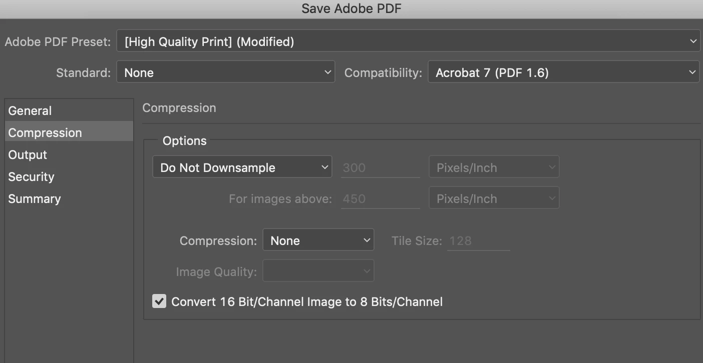

    Check your compression settings on export in the pdf preset screen. Use the High Quality Print module. Compatibility Acrobat 7.0. Turn off ALL compression settings i.e set compression to none and Downsampling to Do not Downsample.
    You will get a really big file size but quality should be good

    the PSD image is around 3300 x 3300 pixels, or so, and its at 300 dpi in the settings. I think my export to PDF settings are off maybe.

    I apologize, the original is in Photoshop and I was doing Save As in Photoshop as a PDF, using High Quality print and I got the above result. Indesign wasn't involved in the process, yet. But, I am thinking that maybe Indesign has a better PDF exporter?
    The image is for a box cover with a fairly hard template for me to setup with my very limited knowledge of InDesign. So, I was using the PDF template they supplied and I opened that in Photoshop, applied my box lid image, and exported as PDF. To the above result.

    all default PDF export settings will downsample your data if your original PhotoShop artwork is highres. That means more than 450 ppi effective resolution. Change that in your export. Do a custom preset for export. Say no to downsampling.
    Uwe
