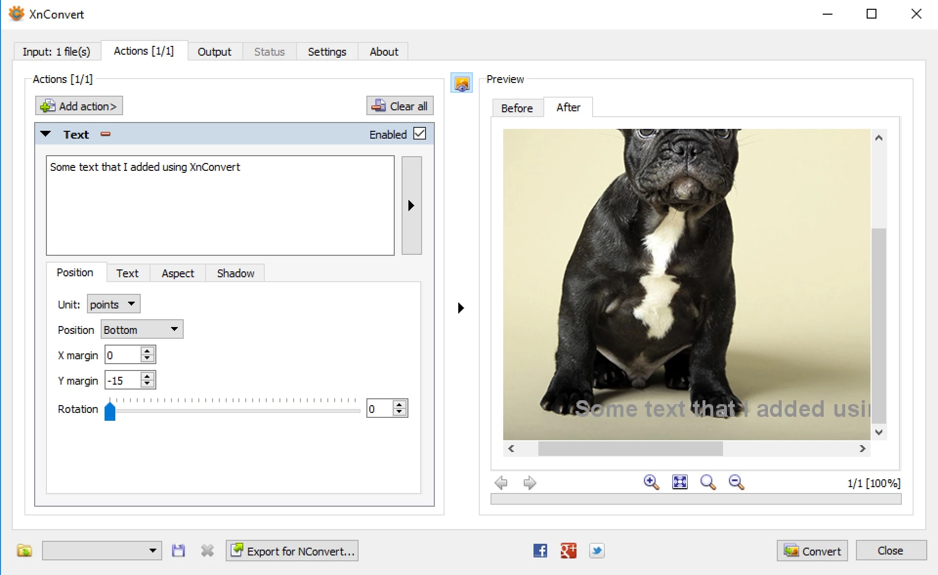

Here is an example from XnConvert, which is a GUI so it will have some overhead over and above a CLI tool (XnConvert can output code for use in the CLI based nConvert, which may have better performance):

I then went into my Windows 10 virtual machine that is running on the same Mac, so there is the overhead of running two OS at the same time. I then used XnConvert to perform the same action of watermarking the same 500 source images with text. The run was approximately 3 minutes. I could have downloaded and installed XnConvert on the Mac, however it was already installed in Windows so ran the test there. I doubt that the deciding factor is the OS, it is the program. The right tool for the job, horses for courses and all that.
Photoshop: 28:40
XnConvert: 03:02
There is no guarantee that XnConvert will crash or stop processing after processing thousands of images, however on this simple test I am backing XnConvert over Photoshop for performance and reliability of batching many images with a simple addition of a text watermark. It would also be informative to run the command line nConvert, ImageMagick or GraphicsMagick tools as well as they don’t have the processing overhead of a GUI, however they usually have a longer/steeper learning curve for installation and use.
