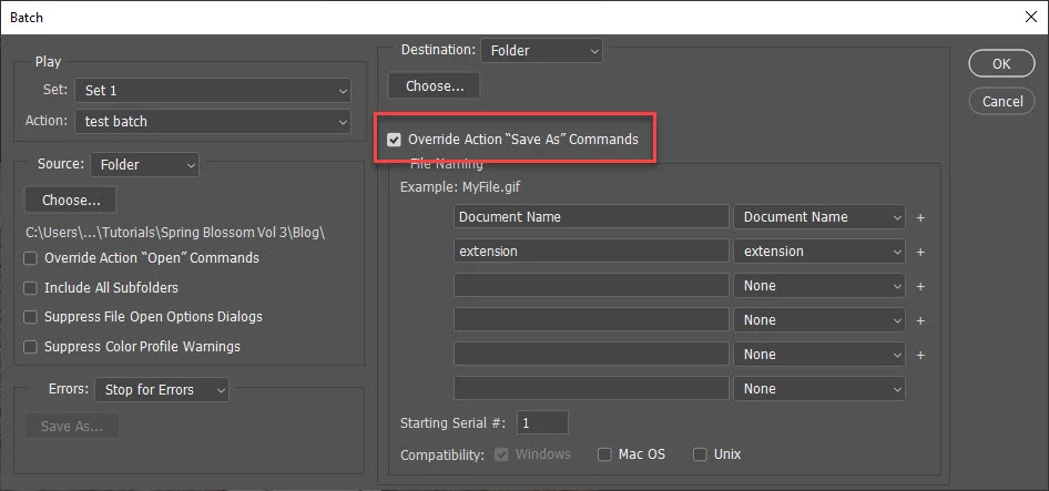

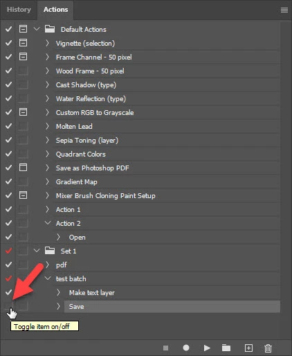

I see two solutions for your problem.
Solution A:
Check Override Action Save As Commands in Batch dialogue and use actions with Save step.
Solution B:
Excludde Export and Save step from action without checking Override Actions Save As Commands.
I do not see Export step and what is recorded (probably Save for Web) but in any case you must untick or exclude that step by clicking on the left side of step to dissapear checkmark as shown on screenshot below.

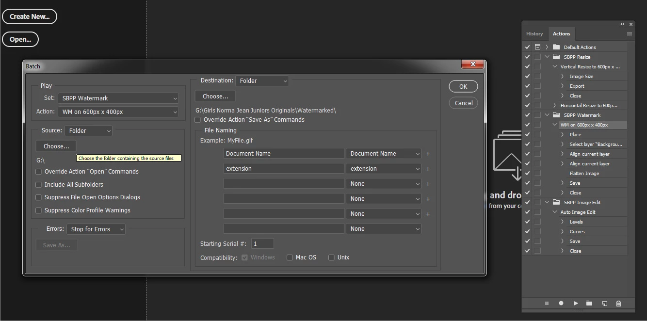

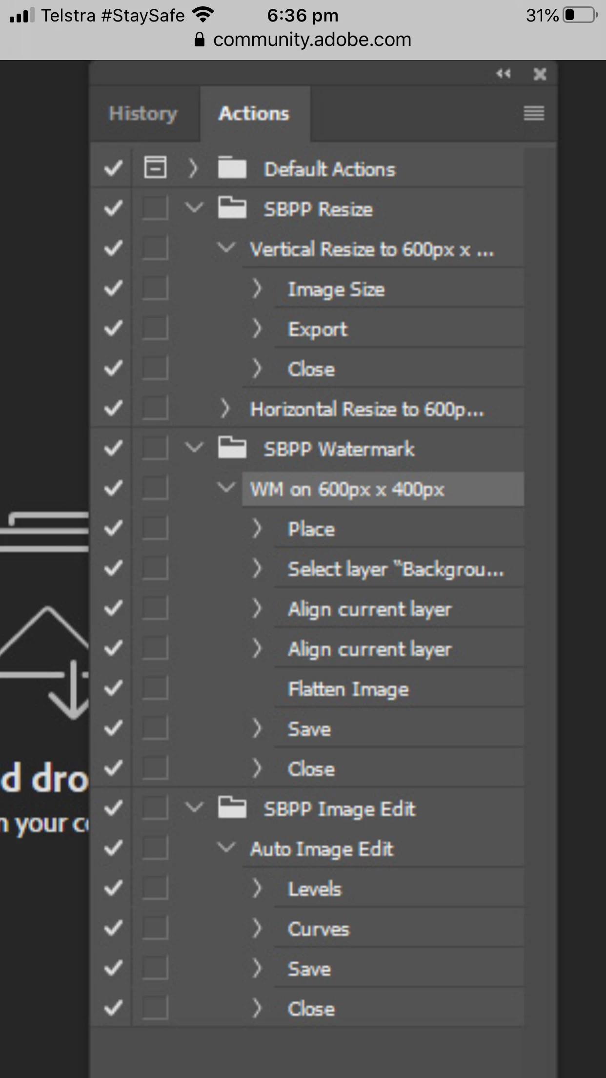

From my testing everything works fine. I am assuming you do not have Save As step in your action. Can you please take screenshot of your action steps and post it here?
One more thing, on your screenshot I see that drive G is selected as source folder, is that what you want or mistake in screenshot?

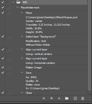

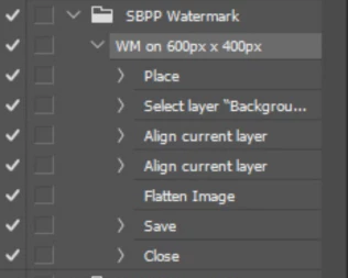

When you Post actions it would be very helpful if you would fully expand the actions so we can read how you recorded the actions. When you post actions that are not fully expanded we can not see the settings you have recorded into each step.   This is very important. Very few Steps can do things relatively using Relative percentage settings and steps like Save As can be recorder two was. One ways has hard coded the output path and file name and would need to be over ridden by Batch else the same file will always be written and overlay to previous saved file.  The other way just records the output path no file name is recorded. When that action step plays the current document Name would be used as the file name.
Lets look at one of the action posted.
Because step are not fully expanded its harder to realize.  The First step Place we can not see what kind of image was placed in for we can see  the steps settings. We can not tell if the watermark may contain transparency, or what  size the watermark may have been or if you sized and positioned the watermark via the Place Transform.  All we know is some image file was most likely placed is as a smart object layer because you Photoshop preference is most likely Adobe default setting Place in smart object.  The Watermark smart object layer will be the current Photoshop targeted layer.
The next step Select Layer "Background" was not a normal  target background for the next step is align current layer.  Background can not be aligned for background layers do not support transparency they are a canvas sized background layer.   So the Select Background step was most likely not deeded.  It added the  Background Layer to Photoshop targeted layers.  This step also created a document dependency for the action.  The Action required that the document it is use on have a background layer. If it does not the Action will fail with an error message.
The next to Align Layer steps align the Placed watermark smart object layer horizontally and vertically somewhere over the canvas for it was also a current targeted layer.  If aligned to edges the watermark would be tight to the edge there would be no margin.  Normally Actions  would nudge the alignment in that case to move the watermark inwards some.
The next step Flatten Image would flatten all layer into a Background layer the watermark would bet permanently burned into the image.
The Save I can not tell it its a "Save" step or a "Save As" step foy the both record as a "Save" step  If it a save Step the will override th opened files and you will loose your the document's layers if it was a layered document and you will not had a copy of you image without your watermark.
Below I recorded your action one of the ways your action may have been been recorded.  I fully expanded it so you can see the settings used recording the action.
You cans see I placed in a PSD image so the watermark may contain transparency it does not have to be a rectangle. The Place Transform was also used to size and position watermark.   That may have add a dependency on the document size being a particular aspect ration and size.   Actions have problems dealing with documents size.
You can see I aligned the watermark to the center of the document nudging is not needed.
You also can see  I recorder a Save As step and did not record in a file name the action can be batched. Normally I would not record any save step.  I would use a script like Images Processor Pro to batch my action. That Image Processor can save up to 10 image file for each image file processed they can have different sizes and file types.

Hi i think you are not choosing input or output folder settings in a correct way....regards
Ali Sajjad / Graphic Design Trainer / Freelancer / Adobe Certified Professional
August 26, 2020
How could that be?  I select the source folder, choose and select folder.  Then same for destination.  What other way can I do this?
